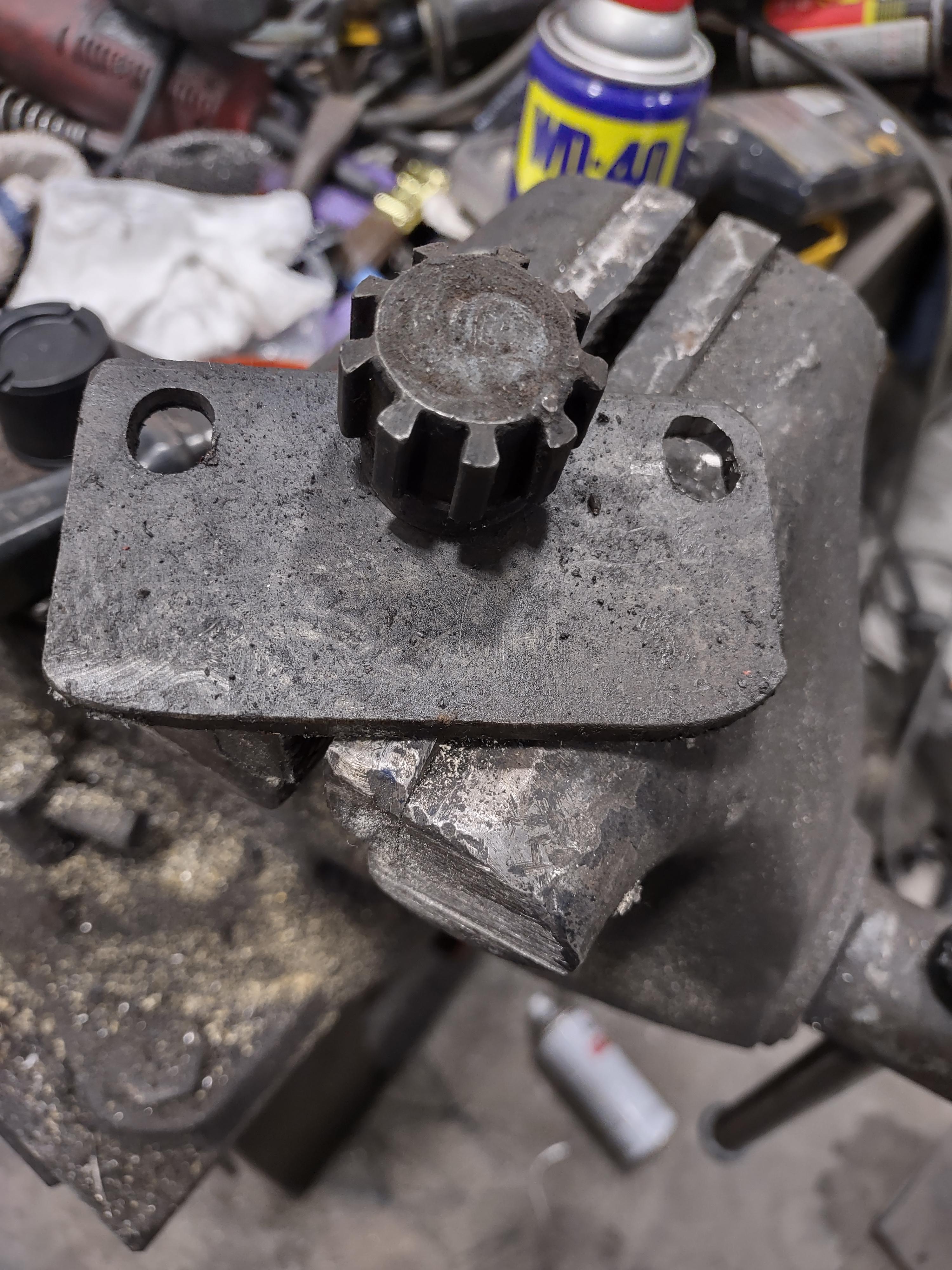

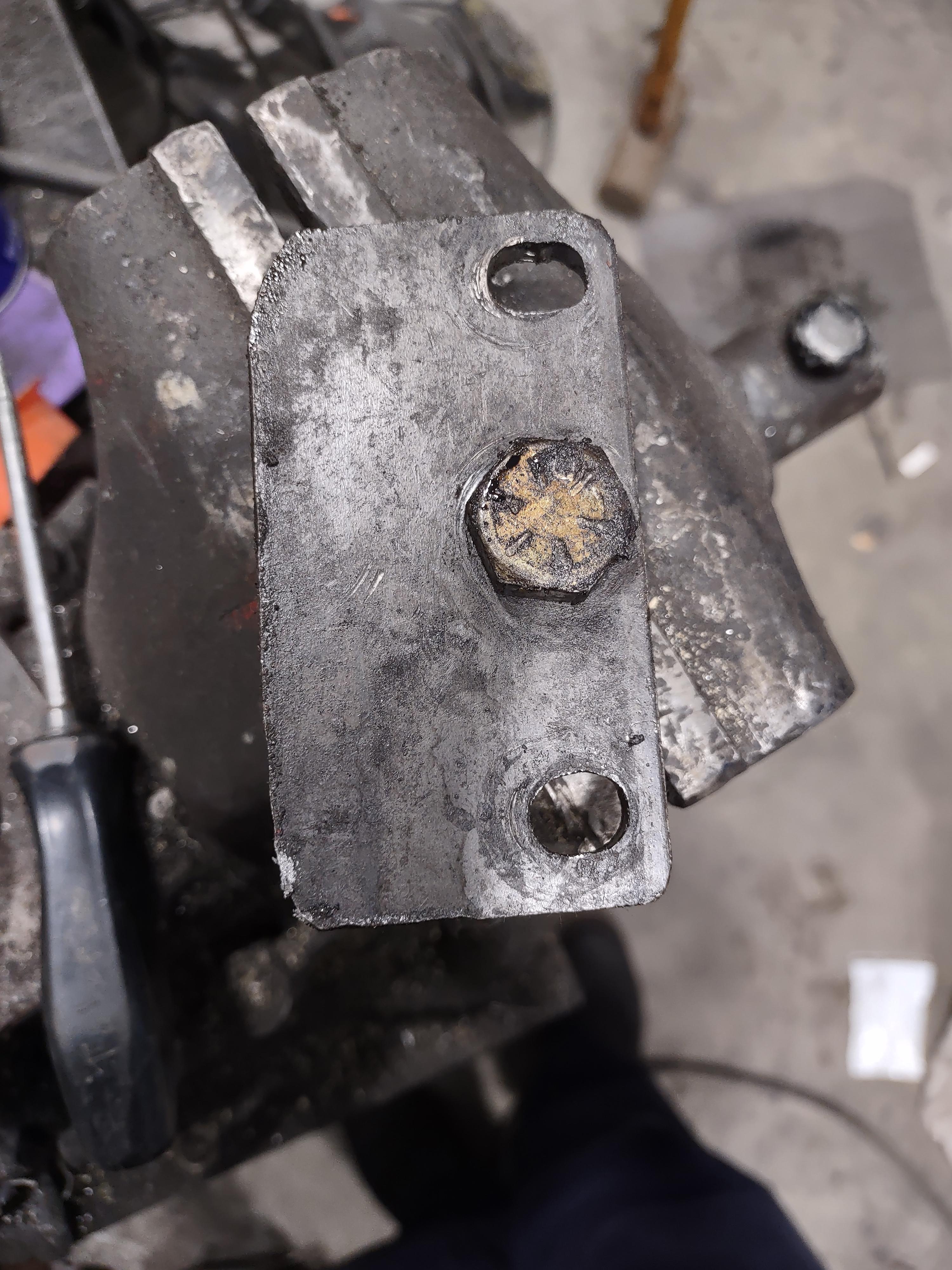

Here's  a handy little thing I welded up from a grade 8 half inch bolt and an old push in typ adjuster.  Bolt it on the cover in place of the push in adjuster and then you can use something 3/4" to get the ring moving sometimes when they're putting up a fight.  Sometimes it works, sometimes it's time for a new clutch.
This is an absolute! last resort! You can also  take the adjuster out and leave the brakes applied and quickly dump the clutch in and out ! If it doesn’t move with this method you will be doing a clutch!  You  don’t want to be doing this inside the shop!  I have managed to get them to move with this method but it’s a bit vicious!
