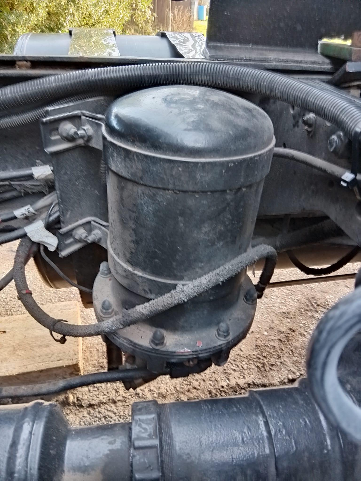

2 minutes ago, Nathanwhit1 said:
Is that a serviceable item ?
Yes, but you have to take it all apart to get to it. I would also replace the desiccant cartridge at the same time. I be willing to bet the check valve on the top of the cartridge is bad also.
The AD-4 is the best, but hardest to service air drier out there in my opinion. It was all I ran and I had air start, never any moisture in the tanks when I would check them.

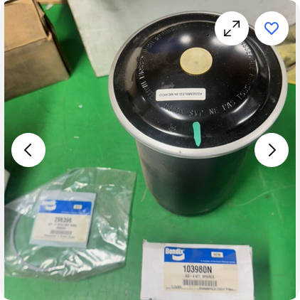

Sound thank you. Just trying to source a repair kit online over here in the uk
https://www.bigmacktrucks.com/topic/75113-ultraliner-air-dryer/#findComment-568409
The pale yellow disk in the center of the cartridge often gets hard and breaks apart. So if buying off of ebay or other such source, be very careful that the valve (yellow disk) is intact and pliable.
While your waiting for the parts to come, you can add a check valve at the wet tank to keep it from blowing off all the air in the wet tank.
