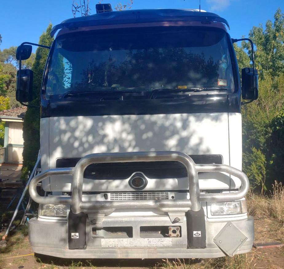

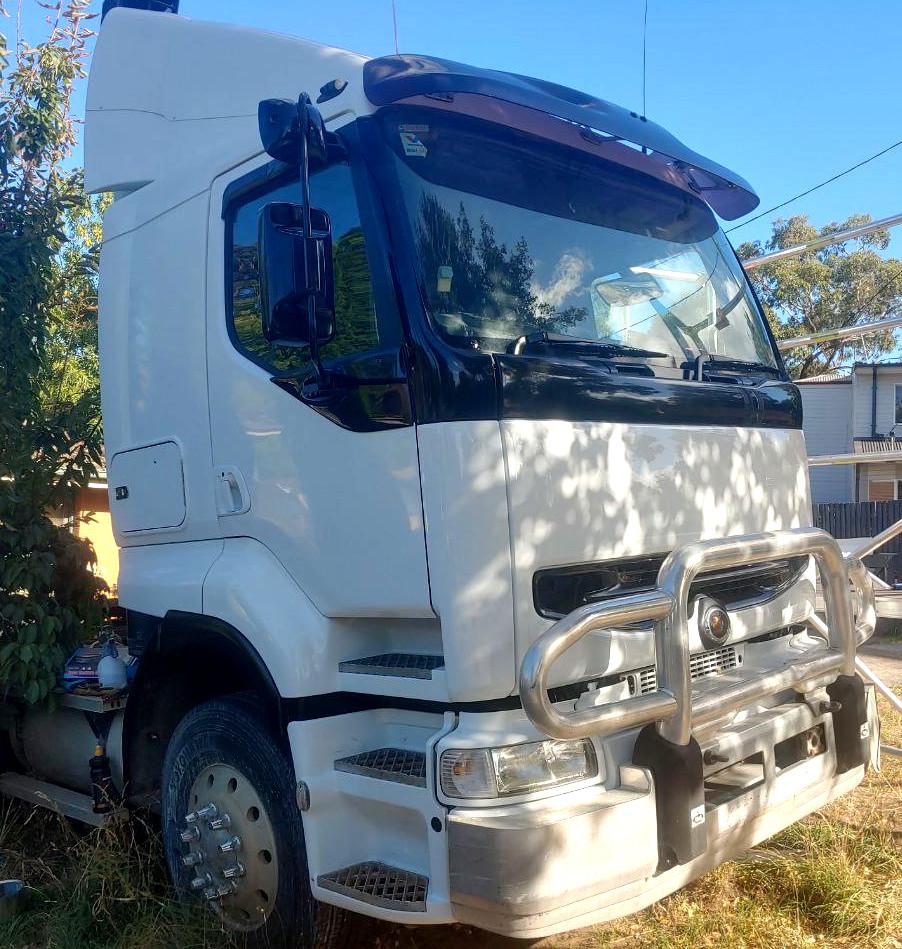

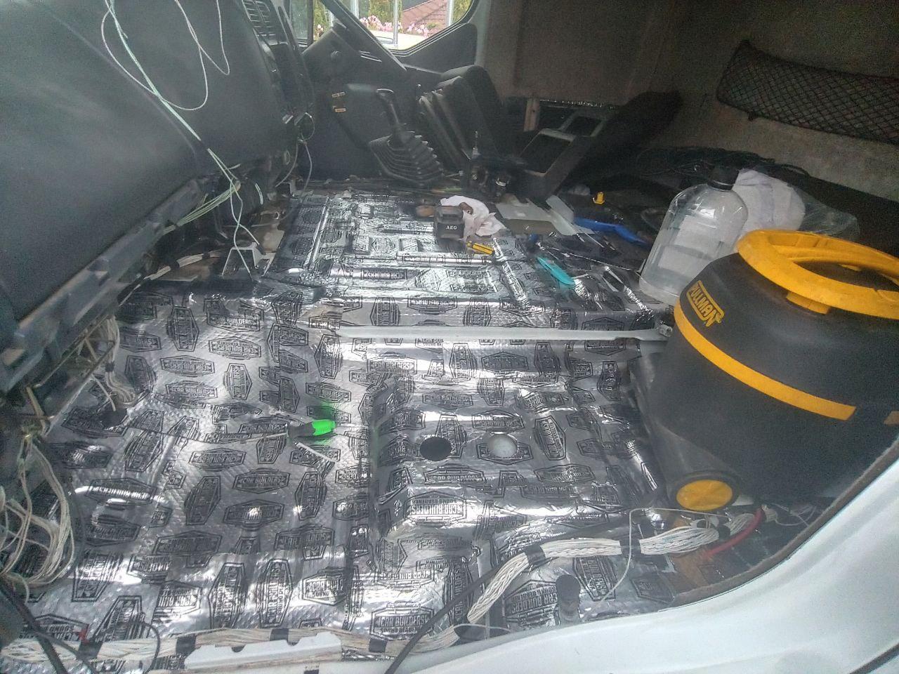

Honestly dont know, but suspect they had the same situation that the quantums had i.e. early models were on renault chassis with e7 engines, later models were mack ch chassis with e7 engines and even later models were mack ch chassis with ISX engines........ i believe this has something to do with emission regulations and the e7 not being able to satisfy the masters (government) so they gave the truck AIDS (isx).  In a few years i plan on rebuilding a Magnum with the ch chassis and e7 engine as while rebuilding the Quantum it hit me i should have gone for the more spacious Magnum.  But still love the Quantum.....im nearing completion to sorting out the wiring, putting TPMS in, adding amp and custome 6x9 brackets for rear, modifying the radio controls on the stalk to also pick up and hang up phone, custom stereo etc etc.  Then i will be adding a pre-oiller (aircraft continous duty type), rebuilding the turbo and sorting the rear main seal out (but still have to make a jig to pull the transmission back to get to it.
