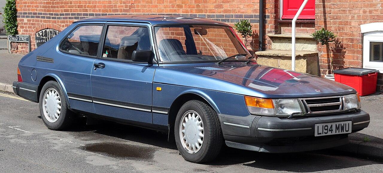

In the 60's Saab made a 3 cyl 2 stroke, it would run backwards and could be driven, esp if you set the timing to close to TDC.
