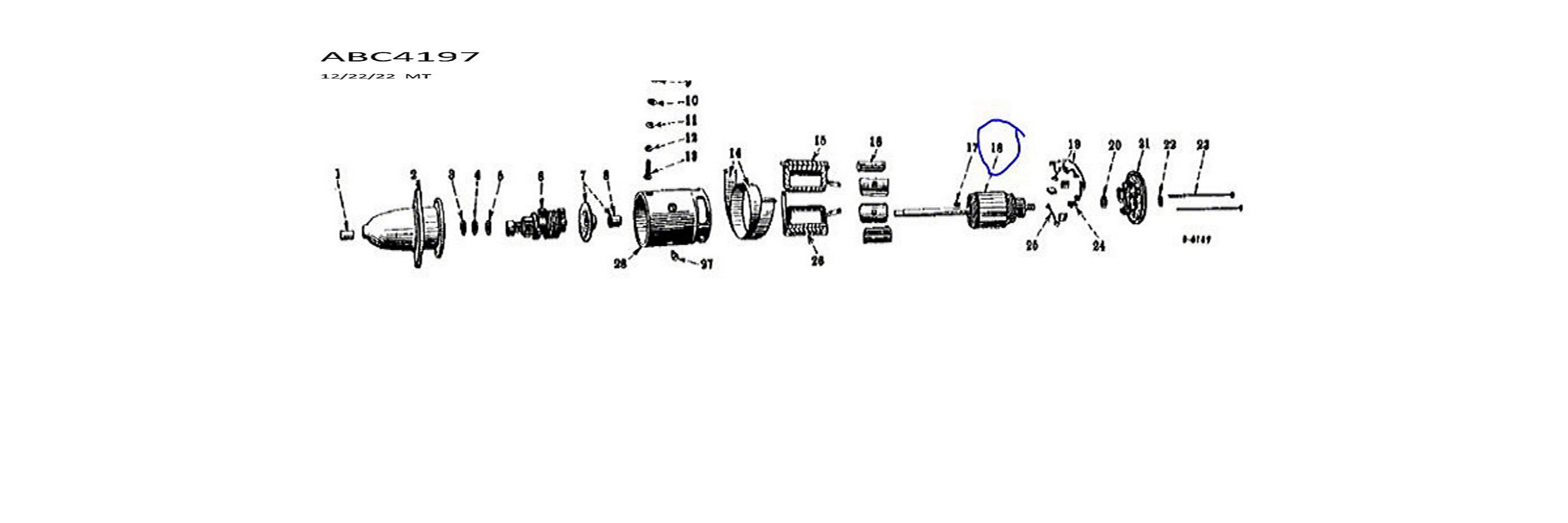

It is a direct drive. see pictures attached. It seems like starters or parts should be available considering how generic these things seem to be, I'm probably just searching incorrectly or don't know what to look for. pics attached.
Did you take the band off the back and look at the brushes and commutator? What is it doing, not spinning at all? Did you try testing it with jumper cables? Pos and neg ground are the same. 12 volts with jumper cables won't hurt it for a test
Looks like the ones on my 269's.
everything should be available for that starter.
They do require lube on the rear bushing.
I can also point you to a modern 12 volt if that is the way you are headed.

I've bought my stuff off ebay, I have part numbers for mine, but no way to look up all Delco numbers.
That said, I am almost certain that the armature, field windings,and bushes would be the same.
