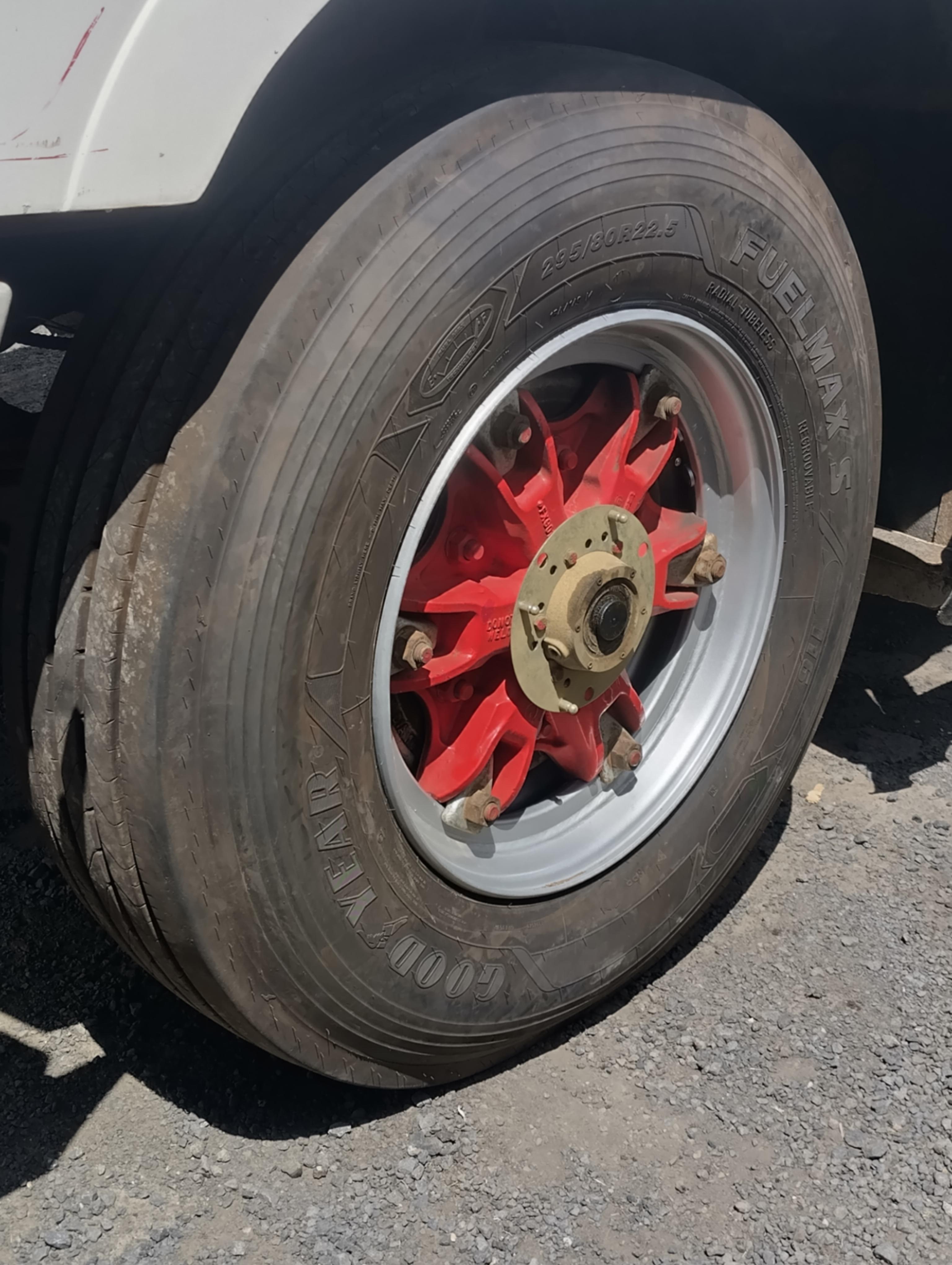

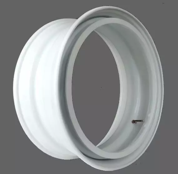

both raneys and gallenger tire sell these wheels...im intersted in buying 2 for my front tires,,,messaged both places and they cant tell me that they fit 20 inch spoke hub,,,,,both me and other dog think this rim will fit,,,tubeless open rim 1100-22-5,,,any other oppinions????? thanks bob

Looks like a standard 22.5 dayton rim to me. No reason it won't fit on a regular 20 inch.
Why don't you want to buy used ones? Any truck salvage yard or tire shop should have some for lots less than new. I know lots of guys here that sell them, but I think shipping would kill you. It should be an 8.25 x 22.5 rim.

I worded my answer very carefully, as sure as S#$% someone is going to measure the hole in the rim and find it is less than 20" and think they need the next larger size! Somewhere I have the exact ID and it is under 20" but that really isn't important to know.
What is: anything that took a 20" tubetype can take a 22.5 tubeless if the correct "tubeless adaptor (rim) is used. Anything that took 22" tube type will take a 24.5 tubeless
Anything that takes 24" tube types takes 24" tube type only!

a1truck wheels,com, actually says that in thier product discription,,,,will fit 20 inch hub,,,,and yes i did believe you guys,,,,just didnt know why two retailers didnt specify that,,,girl at gallagher told me no sorry they will not fit lol..im sure she probably didnt know any better.bob :idunno:
