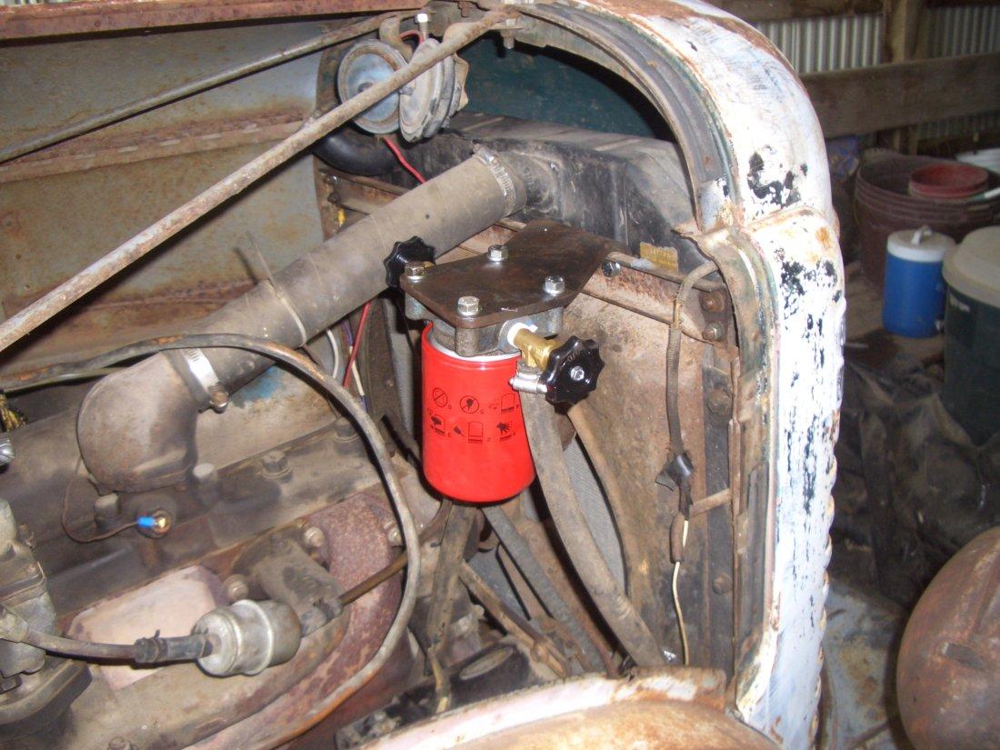

After flushing as best you can, install a coolant filter if the engine doesn't have one. Flushing gets the loose stuff out, the filter removes the stuff that wouldn't come loose at flush time, when it does come loose and starts circulating.
First time ive become aware of coolant filters (sorry only mainly worked on cars), but will look into it 100%...... I like the idea for sure.  Its insane how badly people maintain their trucks (obviously not talking all but most).... one of the main reasons i got my own truck  is because i was so fed up with the badly maintained rubbish they told me to drive.
