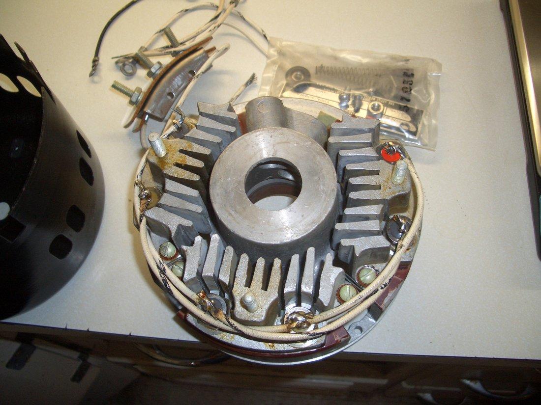

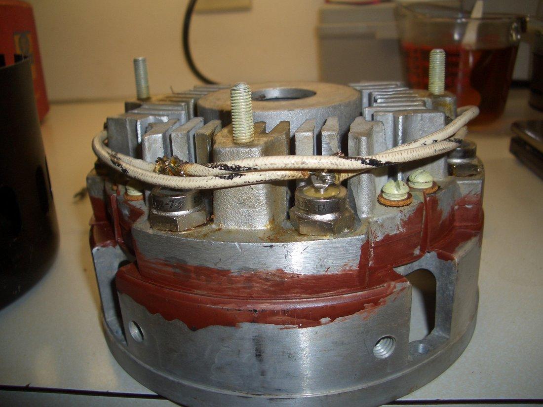

Today I got the N.O.S. Leece Neville kit to update old selenium rectifier units to enclosed diodes like a modern unit. Very well made, and very serviceable.

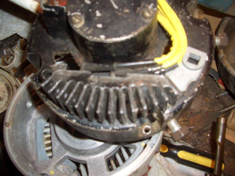

This kit was along the lines of what I was going to try and make. Using Lexan to insulate JB2500 series rectifiers on the back case.

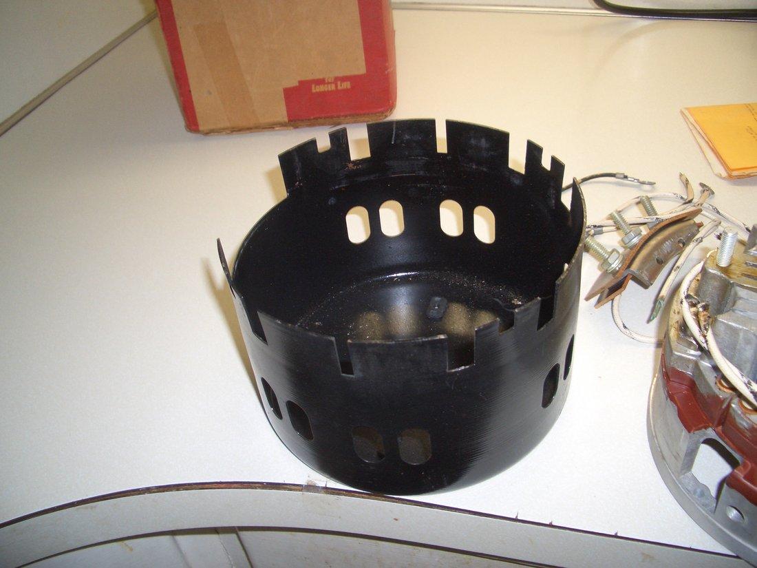

Comes with everything including new  brushes and a new ID tag!
The alternators themselves date back to the 40's at least.
Looking at the kit, it could be easily reproduced. The original rear cover could be machined, the hardest part would be the new stamped steel cover that would have to be made fairly accurately so to clear the electrical parts while still ducting cooling air over the diode blocks.
I checked, the JB series will fit but are "backwards" in that the solid part of the block covers the cooling air duct,These have the diode toward the outside, and the JB has the diodes toward the inside.

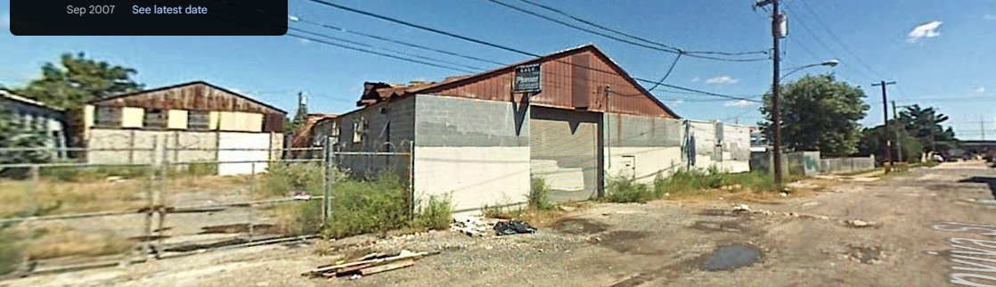

The part in the back had a manual overhead bridge crane in it. everything moved by pulling chains, it was handy
