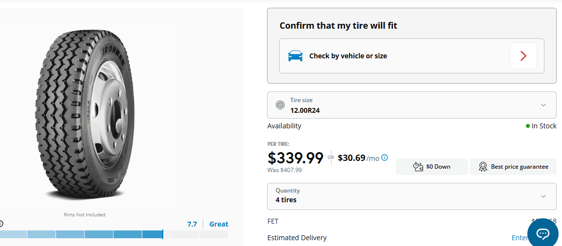

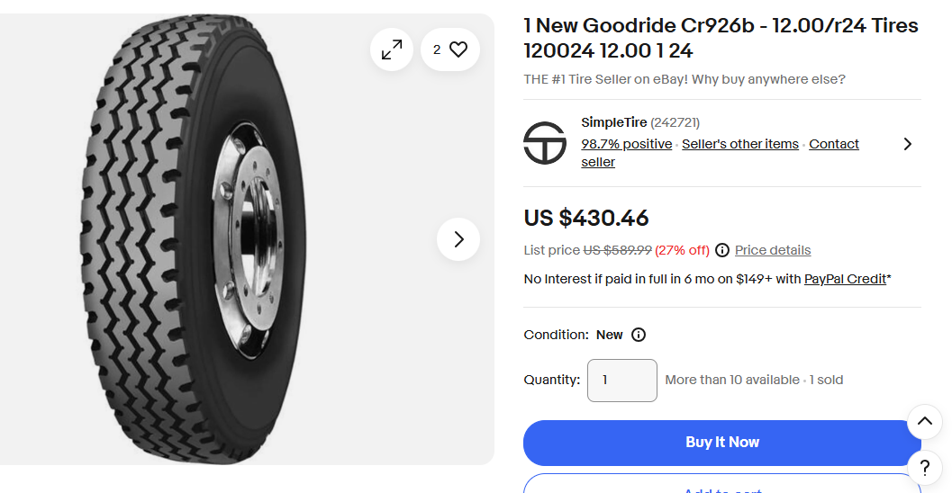

Quick question are tubeless rims available to replace 24in split rim Dayton spokes? Geoff Weeks and others already know the trouble Im having getting tube type tyres and I think the tubeless route is the only option as changing to hub pilot wheels is just too expensive.

I may be wrong but I think I remember seeing some trucks in the Keystone Truck & Tractor Museum a couple months ago with 24 “ inch wheels. Tube type. But can’t ever remember seeing a 26.5 tubeless . If anyone knows what is still available it would be the staff at Keystone .
