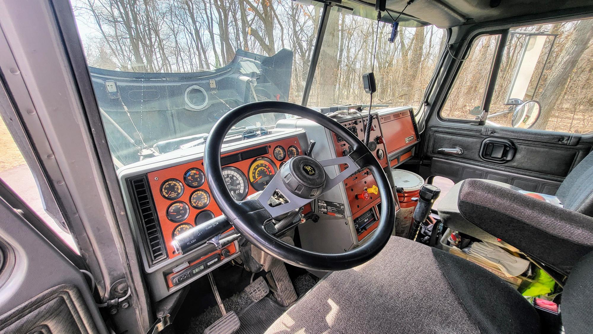

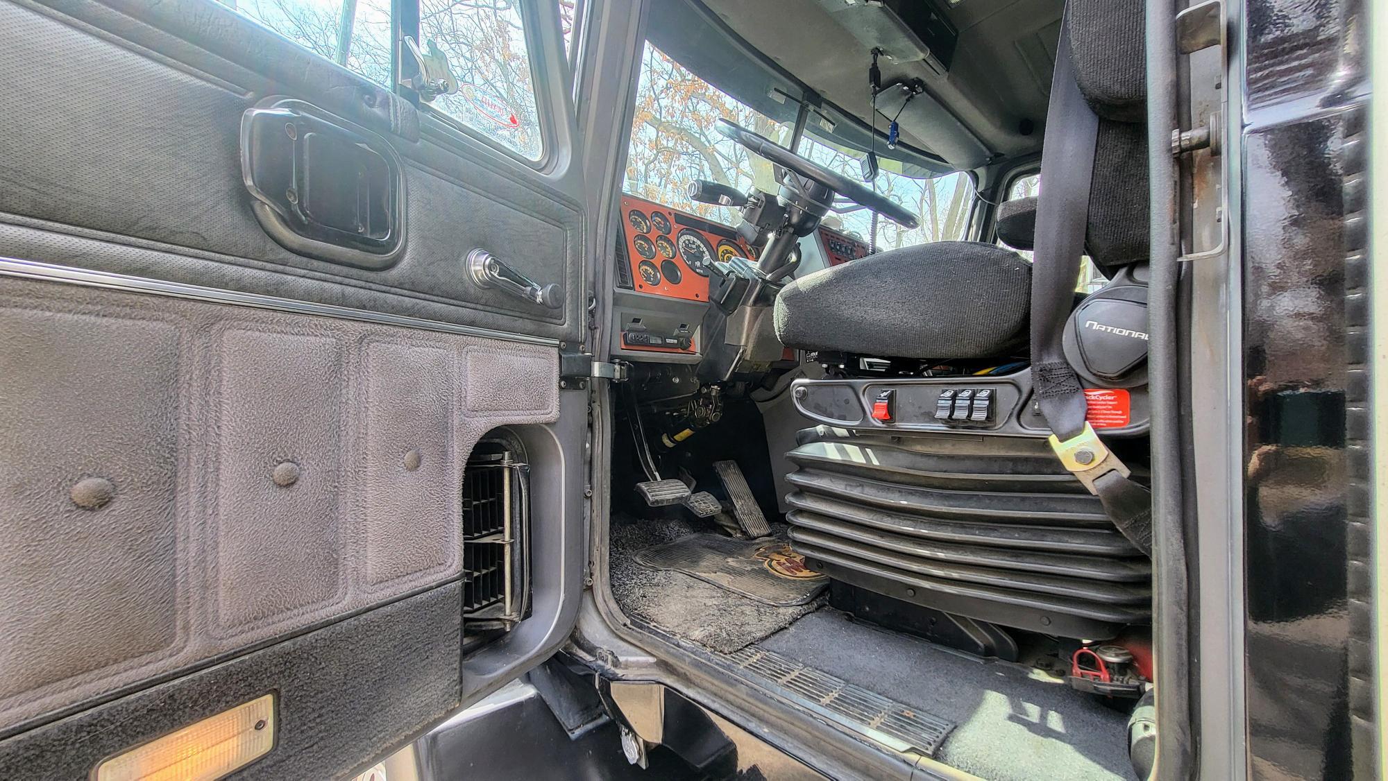

Hey, that’s good to know! I was going to fit my 350 with a 427 turbo but this sounds like a much better option for my 94 as well! I’m really excited to hear back from you when you have a chance to run yours with it a little bit. Have any pictures of your truck?
https://www.bigmacktrucks.com/topic/75261-blixxton-box/#findComment-571653
Not a bad interior for a day cab. Cloth with carpet and wood dash. Lots of foam sound deadening in the headliner and other places too. I think Mack called it the "Preferred". One step below the "Elite". Much better than today's trucks with the snapped together playskool plastic panels that buzz and rattle all day.

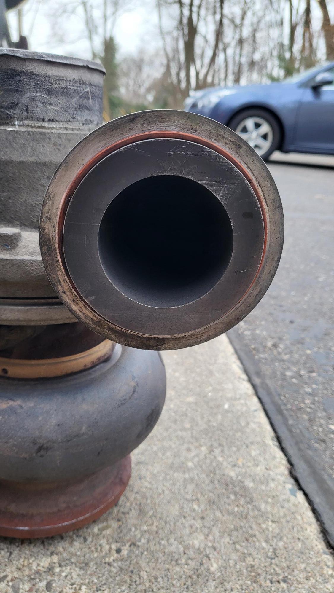

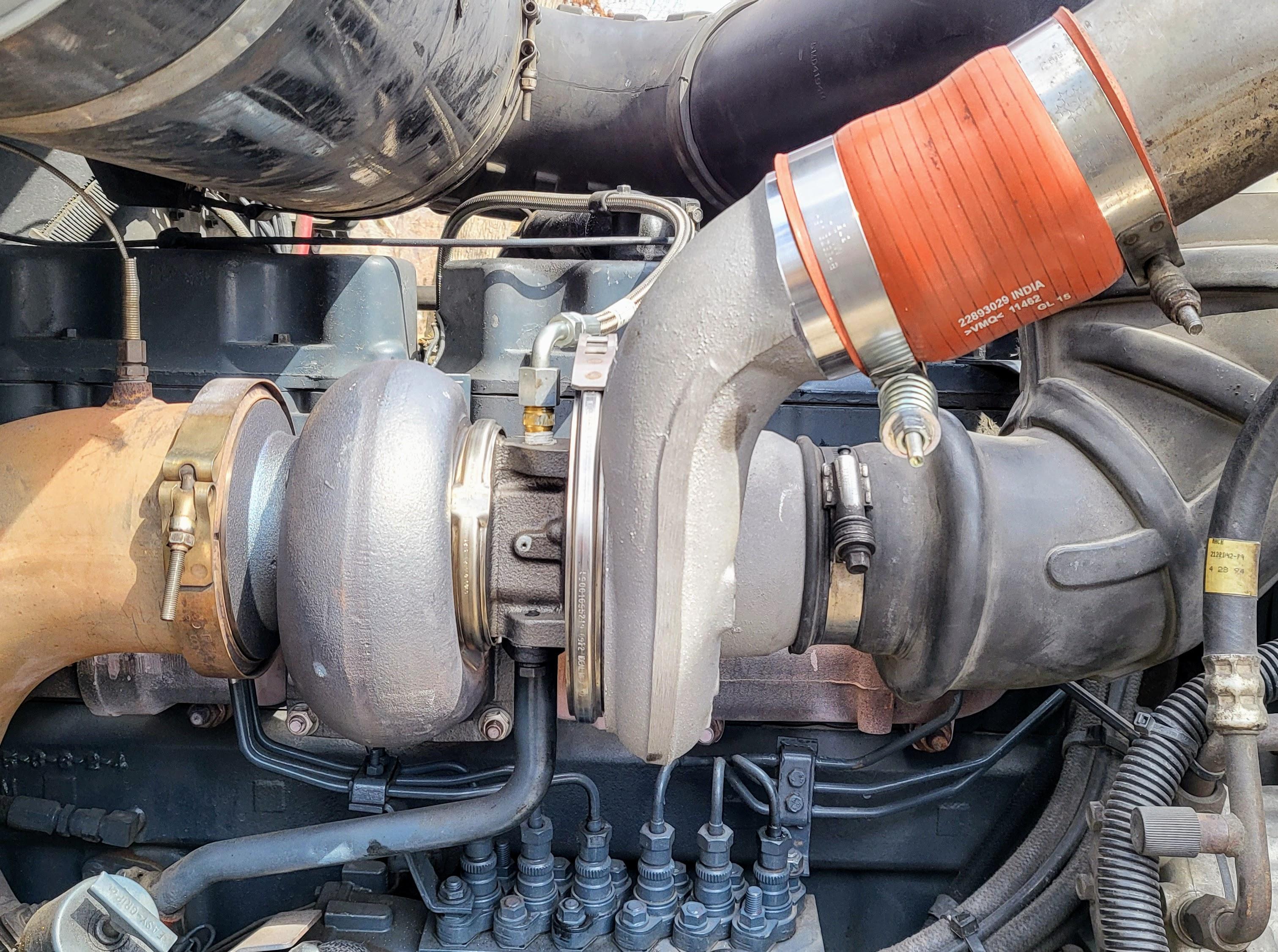

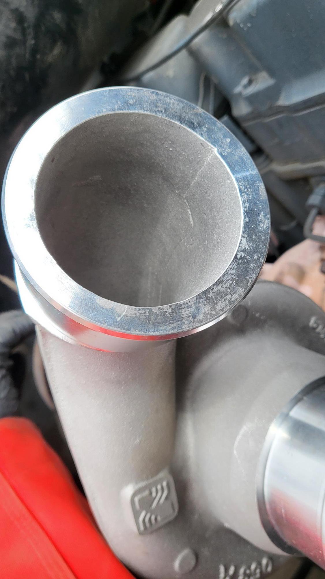

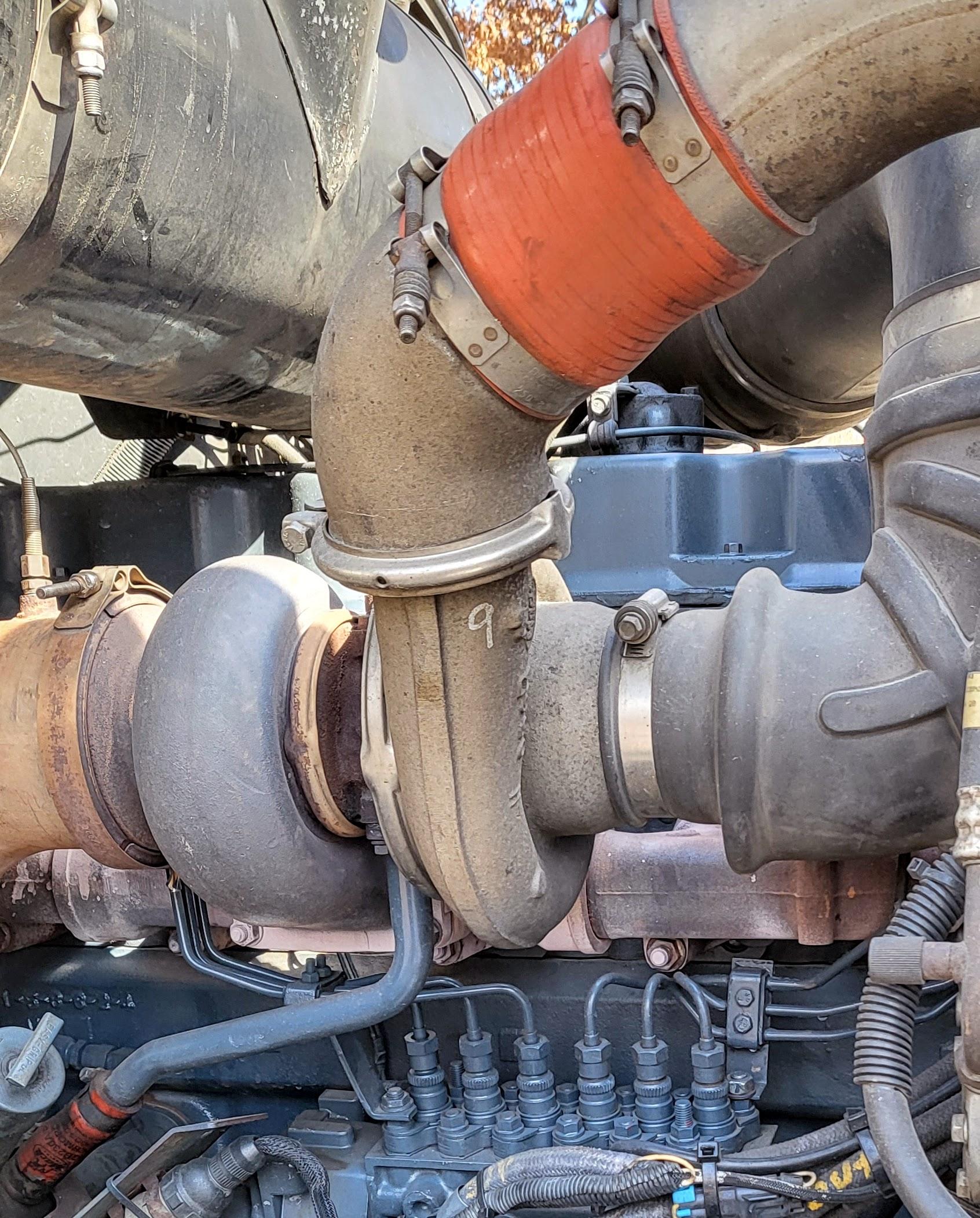

Well, I've run this new .5 stage turbo from Rochester Diesel for a couple weeks now and I'm really impressed with the performance. It's not laggy at all, in fact it spools a little quicker than my 350 turbo. Boost is now a solid 35-38 PSI and that's with my stock 350 injectors and the Blixxton at 30%. The best part is my EGTs are now 150-200F cooler than before. I haven't seen it go over 800F even on a hard pull. I may put it on the dyno sometime as I'm curious to see what it's putting to the ground now.
It wasn't a "direct" bolt on however as the oil feed line had a different fitting so I had to replace the entire line with SS braided and new fitting like what's on the E-Techs. Cheap insurance though. Comparing the compressor outlet between the two in the pics you can really see the difference in flow. A lot more volume of air is being moved and you can really hear it in the cab now at full boost.
