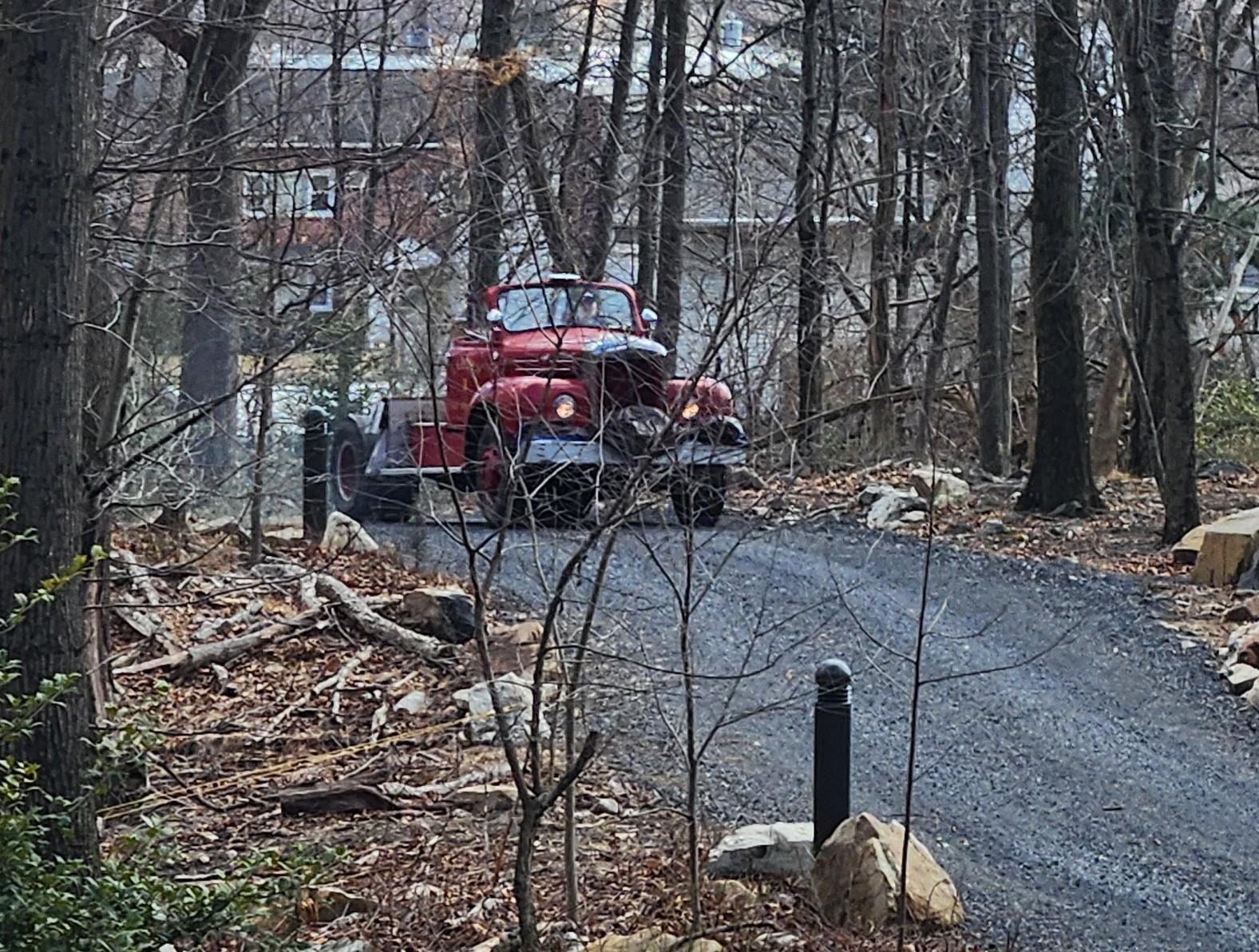

I got it running on a temp gas tank and got it to move around.

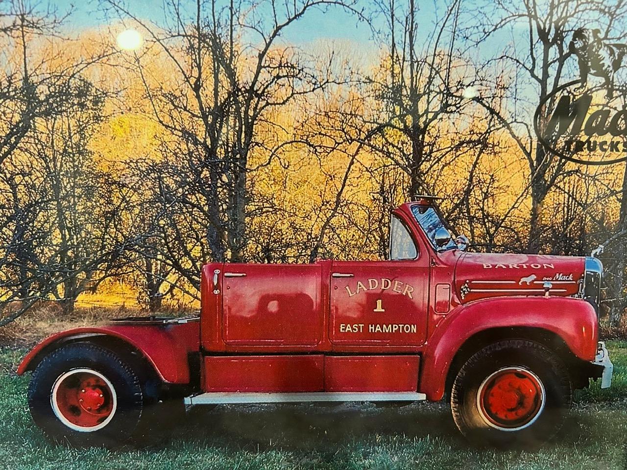

We are just getting the truck running to have some fun with it, the lettering is not original and Tom has talked to the chief at the fire company on door. The current chief researched a bit and found the collector that bought the truck from Boston Fire had his home town  of East Hampton put on door and changed ladder 11 to Ladder 1, along with putting his name "Barton" on the hood. Uh, we already have our name on hood in chrome letters, so I see the hood lettering coming off and not sure what to do on door , she served Boston FD from 1957 to 1979, so maybe she should have Ladder 11 on the door. Truck appears to have been painted once as we can see the Boston taping under the paint. Paint is pretty good and buffs ups to high gloss shine easily. We have an idea and concept photo to make her a four door to haul the grandkids around in, so a total repaint would be then if that even happens. We do have it figured out though....Jack
  On 3/16/2025 at 1:44 PM, Jack Mack said:
What a four door version of our truck might look like!.....Jack
Expand

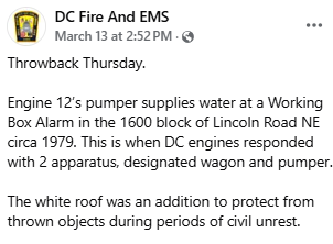

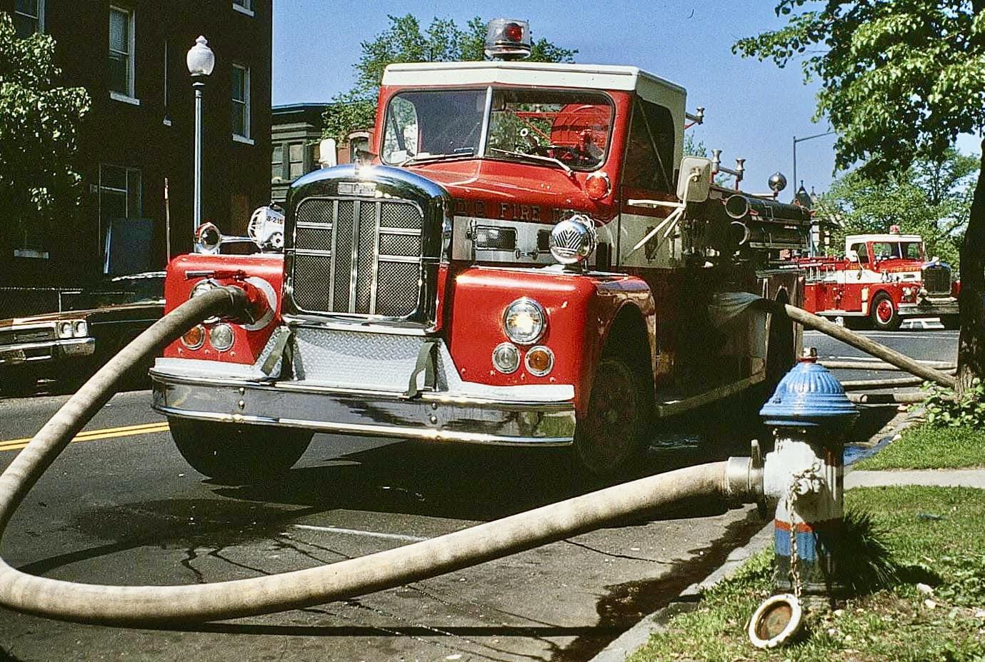

Here is something about open cabs I'd read before but forgotten. That is why they went away in the 60's
