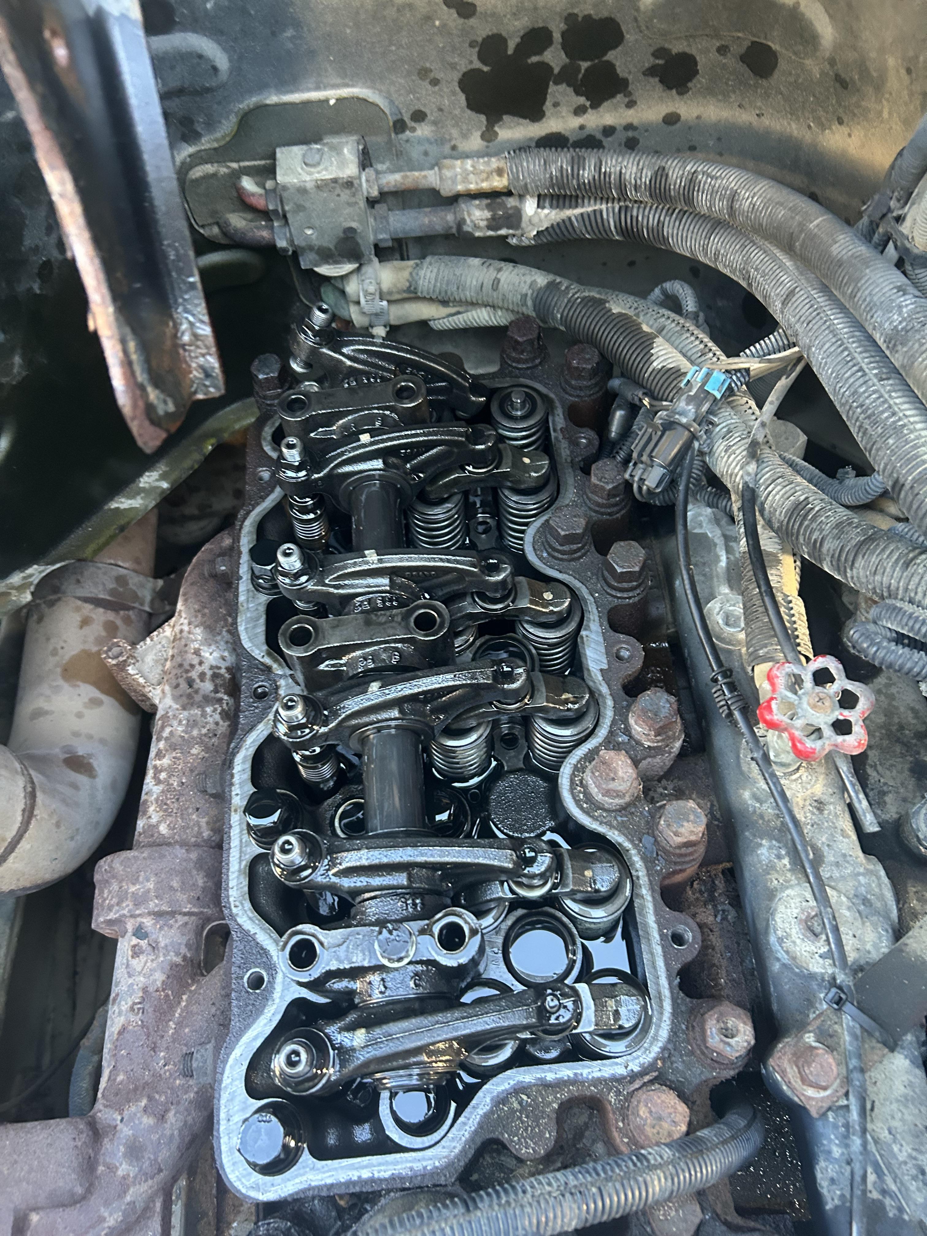

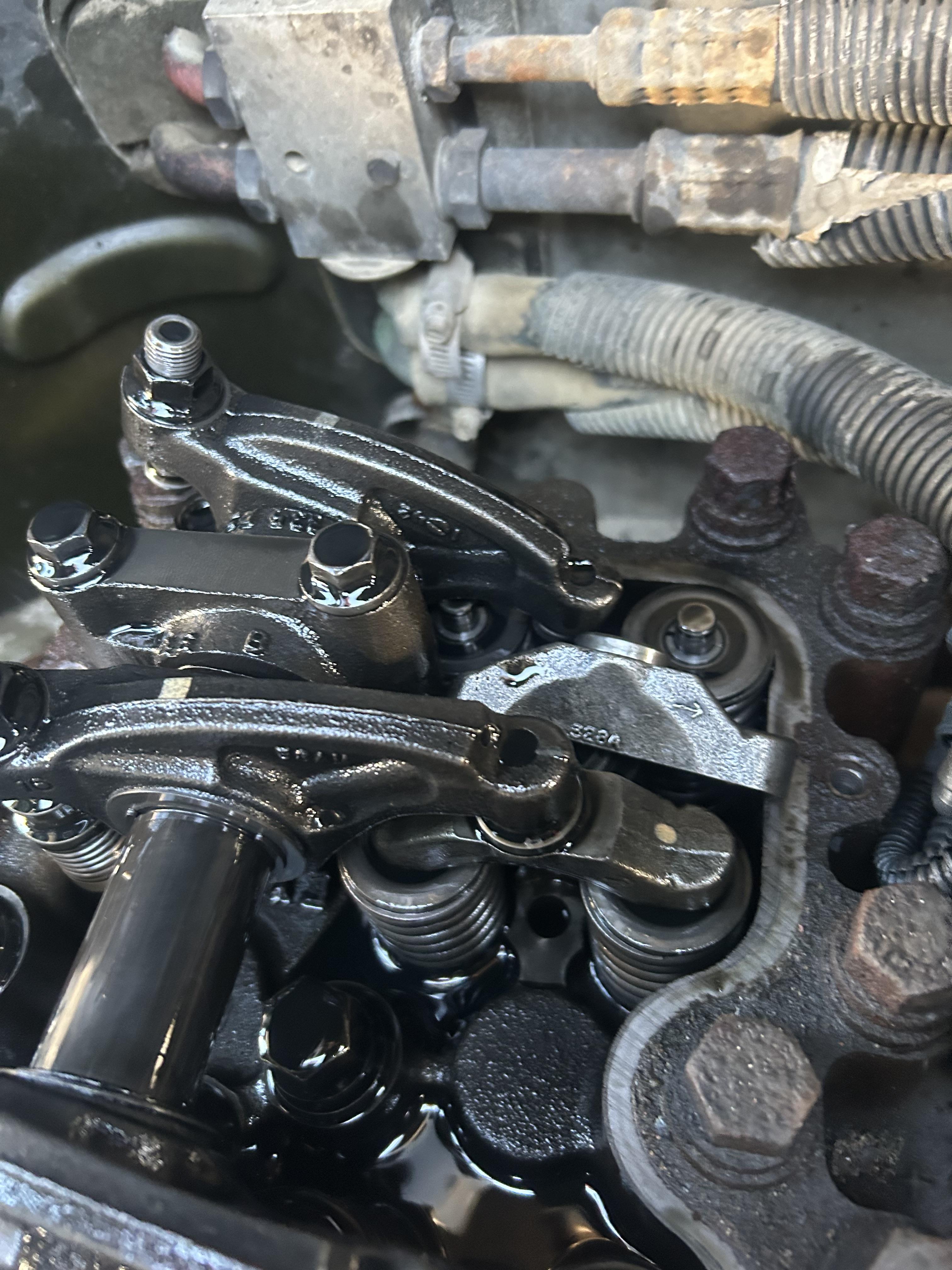

On my ai400 the valve bridge on cylinder #1 and #6 keeps jumping off even after doing a full valve adjustment.  It will run for a few days but eventually I notice a decrease in power and a lot of white smoke which tells me the bridge came off again. I don’t see any noticeable damage to the valve springs or rocker arms. Any idea why this is happening?

So is it possible you have a sticky valve on one cylinder ? one slow returning valve could cause what your seeing! I have only seen it happen once and never resolved the issue! Note be sure to replace the rocker bolts these have had breaking issues in the past! Have you checked the push rods for straightness!
I followed the valve adjustment procedure per the manual and a video off of YouTube on an ai400 with a Mack mechanic. I did pull the push rods and roll them across a flat surface. They seemed fine. I’m going back into the engine today to start all over from the beginning and try it again.  I’ll check all the suggestions so far. Thanks
