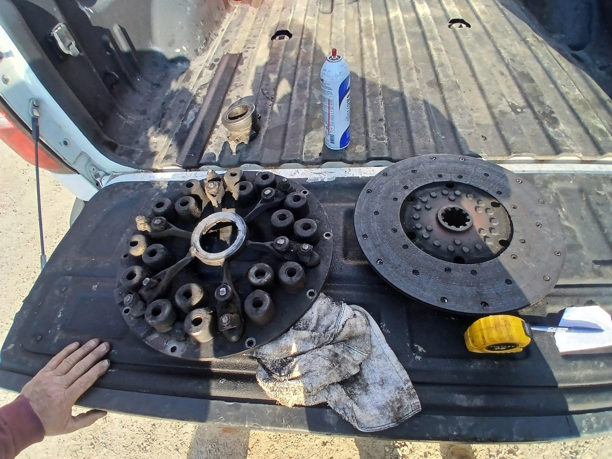

Aight ya'll, the parts guy is calling for help for once. Customer has the oldest truck I've ever looked up parts for, a 1967 DM607S, and needs a whole clutch. Impact actually brings up a little information believe it or not, but it's impossible to read. Truck has an END673P with a TRQ7220 quardruplex. He told me the disc was 15" diameter, and the lookup confirms with him that it has a 2" x 10 spline. Any ideas? I found similar on PAI, but I'm not confident given they are a smaller diameter than what he is telling me.
Sounds like a Mack CL50 clutch. Is it a push type throwout bearing? I kinda remember them being smaller than 15 though. There was s single disk CL58 too, but I never remember seeing one

Single or dual disc?  My Triplex was 2" input, so that sounds correct.  I don't remember diameter?  14-15"?  I had mine rebuilt at DW Clutch in Maryland.

Oh BTW, there are shims needed to install a new cl50 clutch. You remove shims to compensate for wear. If his is worn out somebody probably took all the shims out already. Make sure he has them
