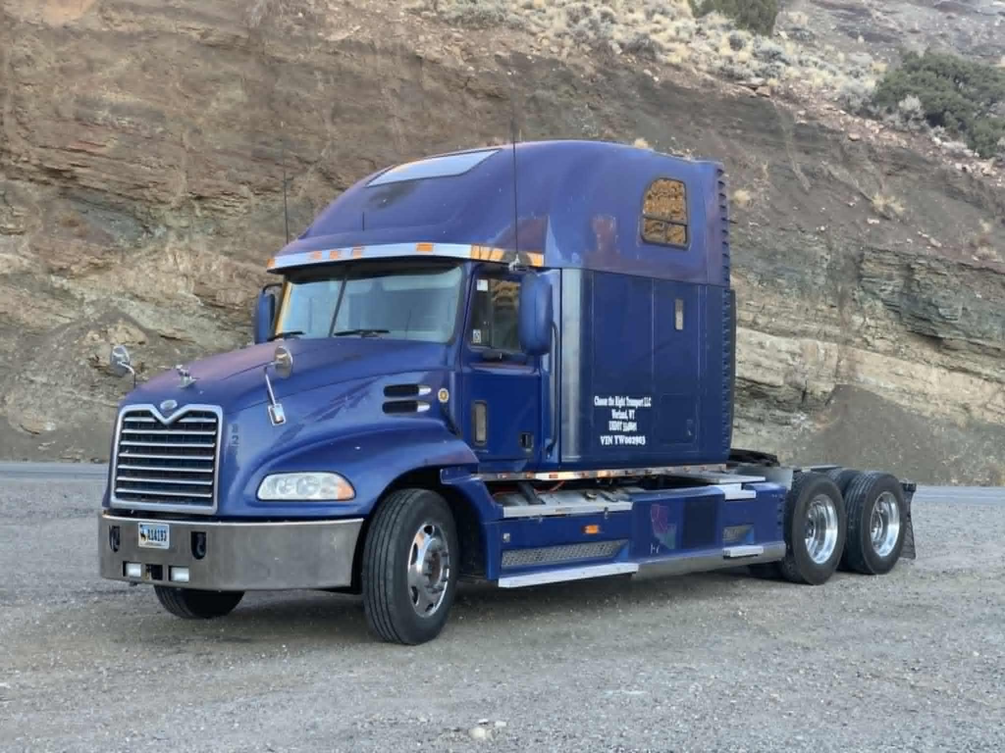

I started an LLC, bought this Mack for $5000 sight unseen, it was a catastrophe, it had 2 million miles on the odometer, I proceeded to put another $5000 into it in parts and do in all home repairs and jury rigging, I live in a small town, and I got permission from the local police to bomb down a specific back road and learn how to chug through the 13 speed. Then I went and got my CDL, then got the authority and insurance and full sent it with $5000 in my checking account, hopes and dreams, and 0 trucking experience with my Garmin and DAT load board. By some miracle, I survived and made money, great money even. Every single time I drove through a weigh station, I felt like I was trying to sneak passed a den of hyenas with steaks strapped to my body, knew it could be my last time as a CDL driver, the truck had a massive oil leak and more things wrong with it than I can remember, every single time I drove through a weigh station, I felt like I was trying to sneak passed a den of hyenas with steaks strapped to my body, knew it could be my last time as a CDL Independent trucker, but the brakes worked and so did all of the lights so I managed to slip through the cracks long enough to save up for a downpayment. I sold the Mack and bought an emissions truck, it was a huge mistake, I wish I had just poured money into Big Blue, but you live and you learn.
I started a post earlier this week asking for help identifying an engine, in this cabover, and I got the help I needed. Now I haven't stopped posting in there and I want to post it more in a proper setting, because this is going to go all over the place. I want it to be broader in scope and easier for the next guy to find information if they're looking for it.

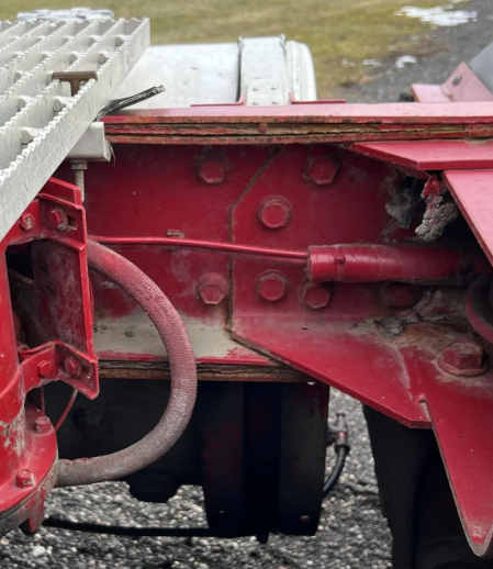

2 hours ago, Joseph Cummings said:
The frame is rust jacked, and if you look at the pictures it appears to be a homemade double frame that doesn't extend to the front axle. That's a parts truck. If I drank a fifth of Tequila, smoked crack, and shot LSD into my jugular vein, I wouldn't pay 45k if I had a million in cash in my pocket
That had me cracking up laughing, it has to be the second most expensive MH i have ever laid eyes on, they have delusions of grandeur, everything has been rattlecanned red and they expect big money for it like it is in museum piece condition. I wouldn't dream of running a 3406B, it is bad ass, and i heard they get 5mpg no matter what youre doing.
