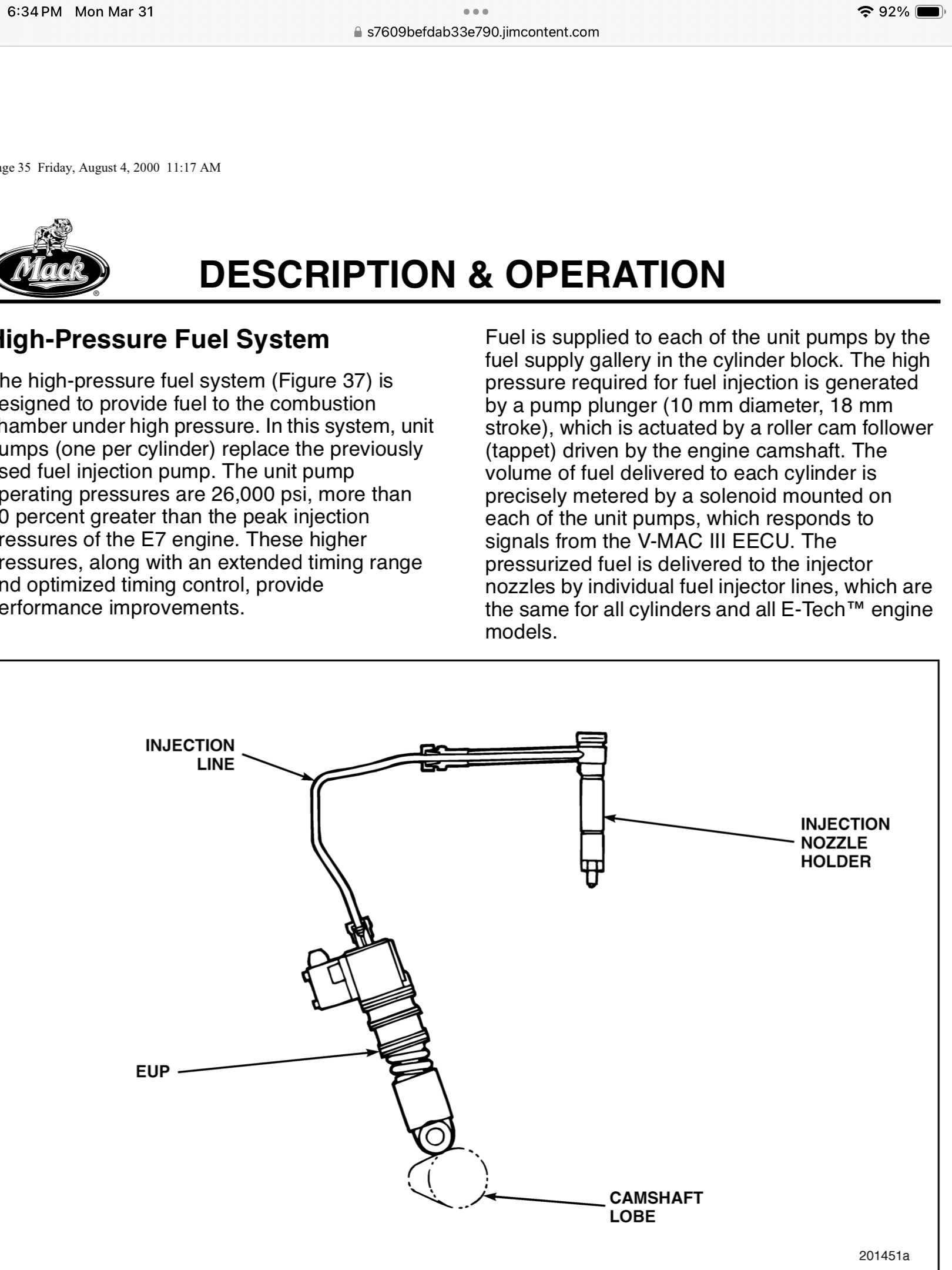

We just replaced exhaust gaskets and of course had to remove the injection lines. Now we are having difficulty bleeding the injection lines. I can’t seem to find the procedure in my copy of SB-210-034.
While searching on line, I also read somewhere these lines are one time use?? Is that why we’re having trouble bleeding?
Any feedback appreciated. Thanks

To bleed them you can loosen them at the head, and pump the primer til they squirt.  Its a little messy.. 2 or 3 lines is enough to get it cranked. As far as one time use,,,,, i have take 320 emory cloth in my finger tips and rotated the ball seat til the groove was gone or mostly gone.  It works 3/4 of the time..  you have to torque condition the nuts to get a proper seating
