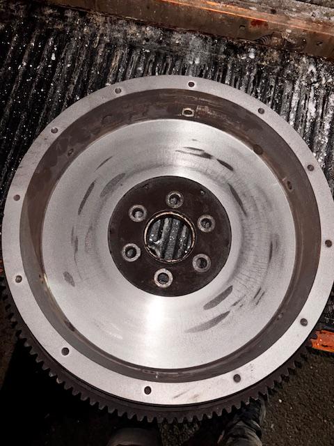

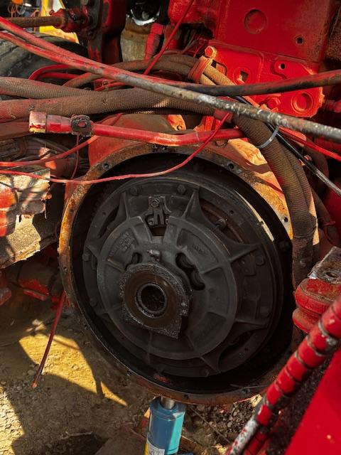

38 minutes ago, Nathanwhit1 said:
It came out easier a lot easier than I thought. The flywheel is saveable and is been done as I we speak. Do any of u know the torque settings for the flywheel bolts and the clutch pressure plate please
Note they must take off the same amount from the mounting flange as they take off of the surface To have the clutch operate properly! thread locker on the bolts 180 ftp pressure plate not sure  15-20  maybe ! 3/8 ratchet tight!

I pulled 170K through a 14" organic coupled to a engine that was was over 425hp and 1400 lb/ft torque. Never wore out an organic clutch, the closest I came was when the pressure plate failed, spilling all its fingers and springs into the bell housing.
https://www.bigmacktrucks.com/topic/75366-clutch-swap/#findComment-572823

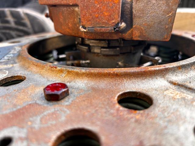

Not sure it will, the Spicer and truck linkage is set up for an internal clutch adjustment. That mean the linkage doesn't change when the clutch is adjusted. That stamped steel cover, I see no internal adjustment, and may be designed for a clutch set up where the linkage gets adjusted. On those the clutch brake (if used) has to have a separate way to keep the clutch brake in adjustment.
Without adjustment internally the throw-out bearing keeps moving as the clutch wears.
I could be wrong, but have always replaced cast cover with cast cover.
https://www.bigmacktrucks.com/topic/75366-clutch-swap/#findComment-572832
There’s a castle nut you adjust behind the bearing for the internal adjust of the clutch bud
https://www.bigmacktrucks.com/topic/75366-clutch-swap/#findComment-572834
Yeah, I know about Lipe, but there are also other stamp steel covers that don't have an adjustment internally. I just want to make sure before he got it together. Not as common as the cast cover clutches.
I admit to being wrong, but better to make sure before it is all buttoned up.
Glad to see him go back with organic disks.

Ive seen those in Iveco trucks. I think Valeo was the brand name. I have only seen a few, and i do not have the spanner wrench in my tool box, which means I didnt see a lot of them.. 😉

1 hour ago, fjh said:
A long screw driver and a hammer works my advice free up those nut’s before you install it!
I’m been all professional and bought the proper tool 🤣🤣🤣🤣🤣 but I can see me using hammer and screwdriver 🤣🤣
