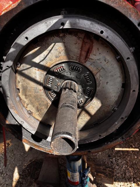

7 hours ago, Nathanwhit1 said:
Hope this pic makes sense buddy
fine spline  2 1/2 --2 5/8 th ??? . same principle as a wheel double nut. loosen the lock nut turn other to lengthen /shorten distance from throw out to fingers. lipe was the common  of that style.
