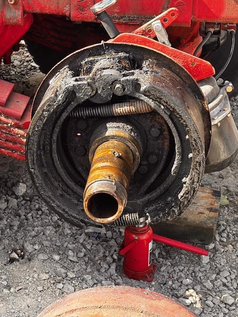

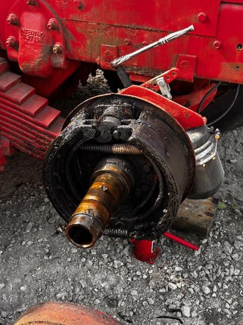

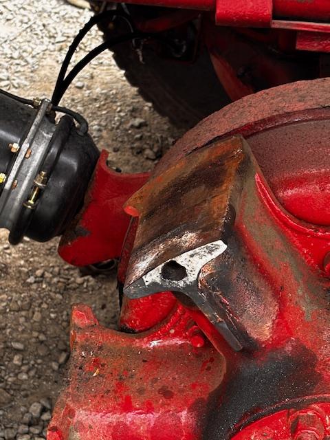

did the stud back out (hopefully) or did it snap off below the spoke surface?
They can be a pain if the stud snapped off. If near the surface weld a nut onto the top of the stud, gives something to wrench on and heat from the arc weld often breaks the rust bond.
Na it’s been a ryt b *******d was snapped below the hub line so tried welding and that dint work so I’ve had to drill it too an inch of its life. I’ve ordered a new tap to hopefully rescue the threads 😭😭😭😭

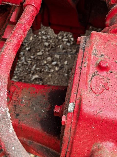

I think 80W-90 is sufficient, it has been used here for decades. Some guys use 80-140 also...
Do you have a chart that shows what grade oil for the climate you live in?
https://www.bigmacktrucks.com/topic/75366-clutch-swap/page/3/#findComment-573670
No buddy
https://www.bigmacktrucks.com/topic/75366-clutch-swap/page/3/#findComment-573671
Is great bung just for that top box or for the complete axle ?
