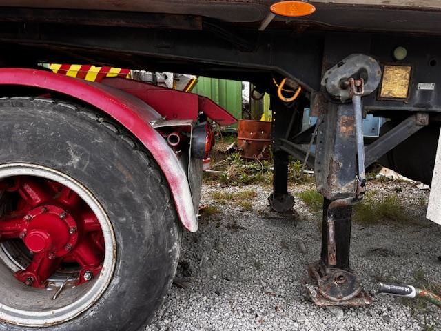

37 minutes ago, fjh said:
Don't know about the the rest of the folks but I have never seen brake chambers like the ones used there! Are these common in Europe?
Not exactly like, but a version of our piston type spring brake chambers.
I guess in Europe, they know enough not to remove the bolts holding the chamber together with out caging it in some way, so don't need our idiot-proof non serviceable chambers that are required here,.

I am familiar with the MGM! Just never seen the ones in the pic!
Yeah they are quite common over here in the uk. There’s so many different ones now. They are a lot easier to work with just unscrew the middle bolt to release the handbrake saves having caging bolts
