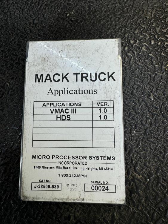

I have a chance to purchase a card for the V-Mac III.  The card number is 801111.  I saw cards with PN 804011.  Which is the correct card or are both the same?  Will this card work with all V-Mac III engines (199x-2003)?  I don't know what years used the III.  TIA

Any ETECH style engine from 1998.5 to 2007 is a VMAC 3 . We used the Pro Link with the VMAC 3 card till about 2000-2001.  We then strictly went with the VMAC 3 software on laptops. Come to think of it I don’t think we used the Pro-Link much past 2000. I know there was some bulletins on using the Pro links on the 2003.5 and up ASET  engines as the VMAC 3 card we had wouldn’t show some things such as EGR or do some of the parameters programming. They might have came out with a newer updated VMAC 3 card that supported the ASET.
