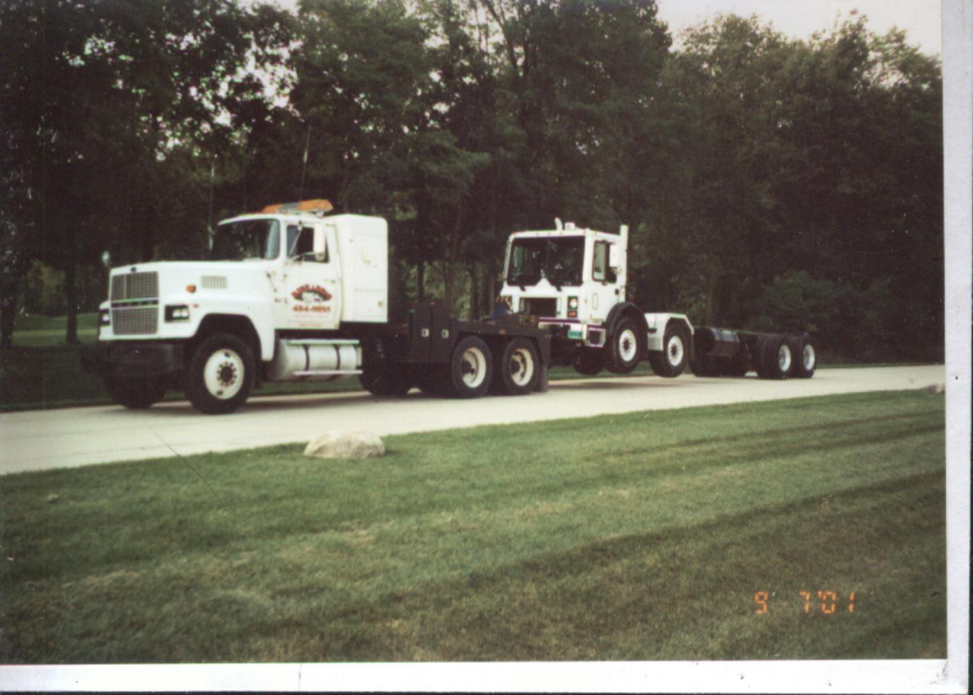

I posted the pic of my Ford, struggling with the concrete pumper chassis, the steer axle was actually bouncing off the ground on rougher streets. My Mack had no trouble with that broke down Peterbilt.
