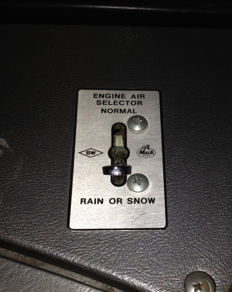

The hood scoop air goes to the charge air cooler.
One duct to the air cleaner goes to the turbo. The second duct picks up warm air from under hood for the engine which was popular in cold climates.
I thought Mack had stop using the second duct for that purpose by this time. Is it possible the hood or air cleaner are not original? I don't trust a truck with only one dog mirror, facing the wrong way to boot. :)

Most likely another victim of misinformation. If I had a dollar for every ENDT676 that was claimed by either the owner or driver to be a 300+,I would be able to throw away half a dozen payment books. Sometimes I think that truck owners told their drivers that they had 300+'s to make them feel like they had more than they did.
i have only saw that setup with the two air tubes and scoop on Canadian R models. they all seemed to have tht same air cleaner with the bigger bottom diameter than the top. some had that weird 2'' angled snorkel tube comin out of the air cleaner for some reason to.
300+'s weren't real common, is that right? I did a little reading on them, and they were somehow linked to California??? Emissions or something?
