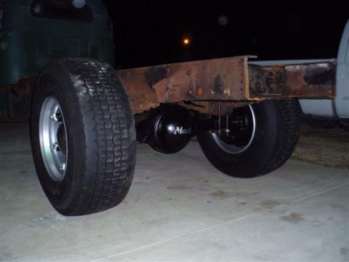

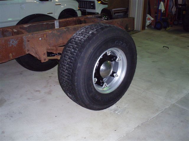

The Super Single conversion is done. I ended up finding this place www.wheelsnowinc.com they custom made the wheels. They ended up being $300.00 less for the pair than the Accuride's were. It's a good thing I didn't go with the Accuride P/N 31659 after all, because they would have been too wide in the mounting area for my hub spokes. Since I had to go custom anyway I had them made to be equal to 3 3/8" spacer and I didn't have any extra room on the spokes. The Accuride's were made to be equal to a 4" spacer.
I'll say one thing. I mounted the tires on the rims, and then onto the truck and boy they are some heavy SOB's to wrestle with. I guess they're a little lighter than a pair of 11-22.5s, but you don't have to wrestle them two at time either.

The Wheels Now P/N is WN31659-MOD and are based on an Accuride 31659 but are narrower between the mounting wedges. My truck had 3 3/8" spacers between the duals and the Accuride's were made to replace duals with a 4" spacer. The flat portion of the spoke on my truck only measures 5 1/2" so I was concerned that I would not be able to get my wedges to fit. Wheels Now can make their version of the stock 31659 or modified for shorter spokes as needed. The Accuride technical rep. actually recommended Wheels Now to me when we were discussing my options, and Wheels Now uses Accuride components to build their wheels. I was also really surprised that buying the custom wheels was $150.00 per wheel cheaper than off the shelf Accuride's. Go figure.
The stock 31659's measure 22.5 x 13 with equal offset.
