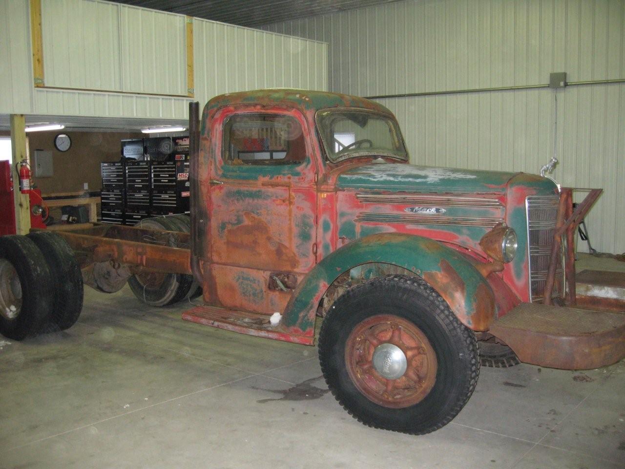

Hi guys, joined the forum after picking up a 1948 EG this weekend. Don't know anything about Macks other than I would like a B model and lowboy someday to take some of my Cat crawlers to shows. Saw this EG and picked it up cheap.
A couple questions for you.
- Someone put a White engine in, what would be the "correct" Mack engine on this model.
- Looks like someone mounted a air tank on the passenger frame, but the truck has hydraulic brake lines. They are going nowhere now. What was the original brake system, hydraulic ?
- Is there a way to lookup the s/n EG 1S 6035 and see what the original build was. Someone cut and extended the frame ( not very well)
- Looks like there are alot of B model parts available out there. Is there a source for parts on the E's such as window moldings, door mechanisms, etc.
I posted some pictures in my album.
Thanks

My EG has an air valve at the hydrovac and a trailer air valve on the steering post.
It also has an air compressor on the engine.
My '48 has a REO engine in it.
Must be an upgrade done at some time.
My Mack history is a bit rusty but Mack and REO were togather at one time.
That might be why I have a non-Mack engine.
Than again - - - maybe not!!!!! LOL

Matt,
I also have a 1948 EG. The original engine is a EN 330 cu. in. Continental. If the tank you see is behind the passenger side running board, it is a vacuum tank. Mine is a tractor and has the trailer brake valve on the steering column. Mine also has hydraulic brakes with a hydrovac.
Mine had a cracked block when I bought it and I looked everywhere for a block to no avail. I had mine repaired at a pretty big cost. Naturally, after I had mine fixed, they started turning up all over. I believe Continental calls them a M330, and I've seen them in a Gallion road grader, Bucyrus Erie dragline, Buffalo Springfield roller, and several stationary applications, like welders, compressors, and such.
I'm no expert on 48 EG's, but I did take mine down to a bare frame and started from there. I haven't touched it in 3 years due to health and financial situations. (those 2 things seem to go hand in hand!) Feel free to contact me with any questions you may have.
Tom
https://www.bigmacktrucks.com/topic/7980-model-eg/#findComment-29315

WWII surplus White halftrack engines were a popular repower,because they would bolt in without many modifications and could be bought cheap.
