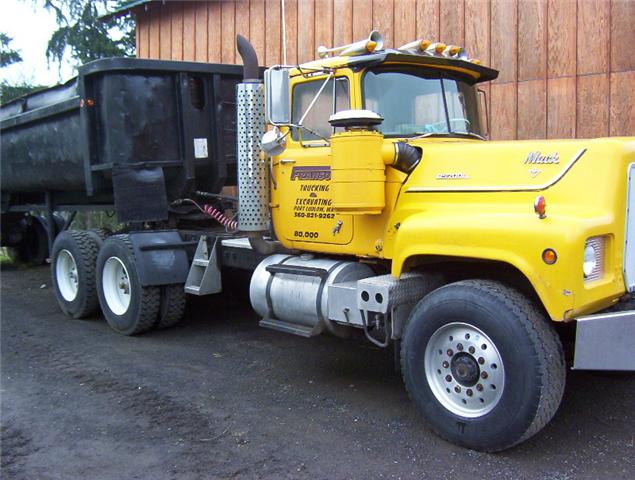

I have this 1975 rs700 l with the 866 V8 and the 12 speed trans. it has 330,456 original miles on it, that came from army corp. of engineer. I was woundering when should the main and rod bearings be rolled, and the turbo change out, and what is the valve adjustment intervals? The Dynatard engine break seem's weak, what kinda tune up spec's are there that i can check to see if it is just out a spec.
On the mack 12 speed trans is there a filter that needs to be changed looks like a filter up on top of it but i can not get to it very well to see what it is, cant get it off scared going to break off the mounting brackets.
Also this truck has a 18000 pound fron axle is this common in this series a truck or if this a after market something.
What is the steering box worm gear end play spec's.
What is the turbo boost pressure at full fuel at hard pull
what is normal oil pressure engine hot at idle and at like 1800 rpm
what is oil spec's for the engine multi grade or like a 30wt.
what is the factory governed rpm
what is the exhaust temp max at hard pull?
Sorry so many quastions but i know nothing about mack engines and I really need this truck to keep my grinding operation going. thank you for all that reply.

thank you all for your help!! I am not understanding the valve settings? I have not yet pulled the valve cover to loook yet but would .023 be less tight than .022. my engine is silver and has a 12 speed mack trans. behind it and 44,000 ibs axles with 18,000 front. this is the nicest 1975 trk i have ever seen looks like it just came off the lot, not a scratch. i am using this trk to haul wood grindings out of the mountains to a generation station to make electricity. this trk is almost to nice to drive in the mountains. I not sure if it a good deal but i got it for 5k with new tires all the way around. The o-rings that i should check are they easy to see, or anyone have a book i can buy. or know where i can buy one thanks again for everyones help
