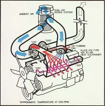

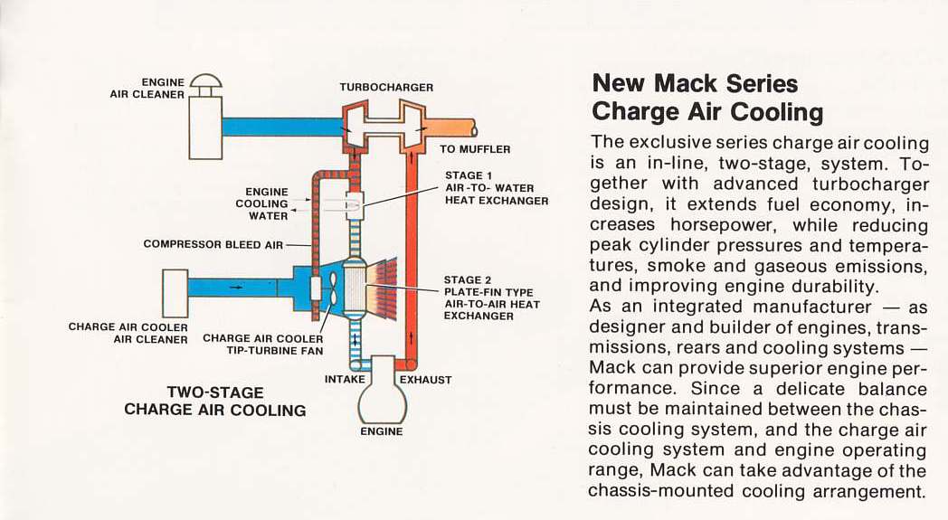

I'm no expert but The tip turbine engines had the intercooler mounted to the top of the engine on the water manifold and air was forced into it by a small turbine on the back which I believe was driven by exhaust gases. In the brochure above they are the 300 maxidyne and 300 plus engines. Sometime in the early 80's Mack did away with this arrangement and had the intercooler mounted in front of the main radiator. There was no turbine forcing air through it. I think they started calling these engines Econodynes but somebody correct me if I am wrong.
On 6/18/2016 at 0:59 AM, sodly said:
Yep, got that brochure, too.  Dumb question here.... can you explain the "tip turbine" engine and "radiator mounted charge air cooler" for the ignorant?
 Tip Turbine used boost from the turbo to spin the turbine. the Turbine would draw "cold"air from the 2nd tube on the air cleaner and pass it thru a charge cooler to reduce the temp of the boosted air. A front mount intercooler works much better but there is no mistaking the sound of a tip turbine.
Many people dont know that there were a few versions of the side mount charge cooler. Some were air to air only others  had both air to air with a water jacket to help reduce intake temps.
the one shown in the pic has the water and air version

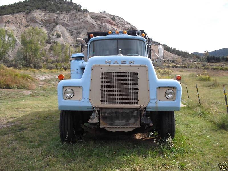

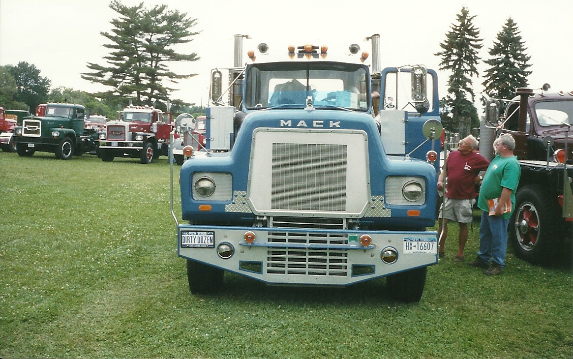

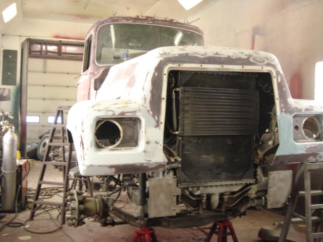

Ok, how about another stupid question about Western Macks?  Why did the "western" trucks have what appear to be larger grilles but with a smaller, reduced-size opening surrounded by the white/silver shroud?  Seems like western trucks were meant for big horsepower.  Wonder why the entire grill wasn't utilized to cool them.  Or am I missing something?
Your pic of the Blue RS700 is what looks like a 1972" or early western. These hoods were basically a Eastern R700 hood with a Western grill. You can see below the hood the grill extends to take up the gap between the hood and bumper. Also the there is openings in the bumper for more air flow to the larger radiators.
Now, look at the gold RS600. This truck is a later western R model as you will see that that the body line on the side of the hood is about 4" above the top of fender. The later Western R models had taller hoods and in my opinion looked better without a gap between hood and bumper.
You can also tell what era Western Mack you are looking at by looking at the gap between the top of tires and fender to see of its a early or later Western.
The cabs of Mack Western R models sat up higher on the frame allowing for a taller radiator options and thus higher HP with Mack and off breed engine options.  The western grill opening is about as wide as the frame rails and thus as wide as common radiators of that era. That being said, you could spec a Mack Western with a standard 6 cyl Mack and the standard radiator was plenty large for what we would consider a small bore diesel.
There are a lot of little differences in early and later Mack Westerns you just need to look close and you will see them.
Just as Lmackattack says, the grill opening is as wide as the frame rails and the Western radiators sat between the frame rails so were limited to this width. However, these radiators were much taller than the Eastern ones. There were also two options. For 6 cylinder and lower HP models a standard radiator sat on a front crossmember which spanned the spring hangers, but higher HP models such as the 866 V8's, Detroit V12's and high end Cummins were fitted with an even deeper radiator. This was mounted to brackets on the inside of the frame rails and the crossmember was deleted. Some of these trucks also had a different bumper with more cooling cutouts.  When the Value liner came out it had a redesigned front crossmember allowing it to take the same tall, narrow radiator that was fitted to some Cruise liners. It couldn't take the wide radiator that was fitted to the high HP Cruise Liner and Super liner because it didn't have a drop front.
