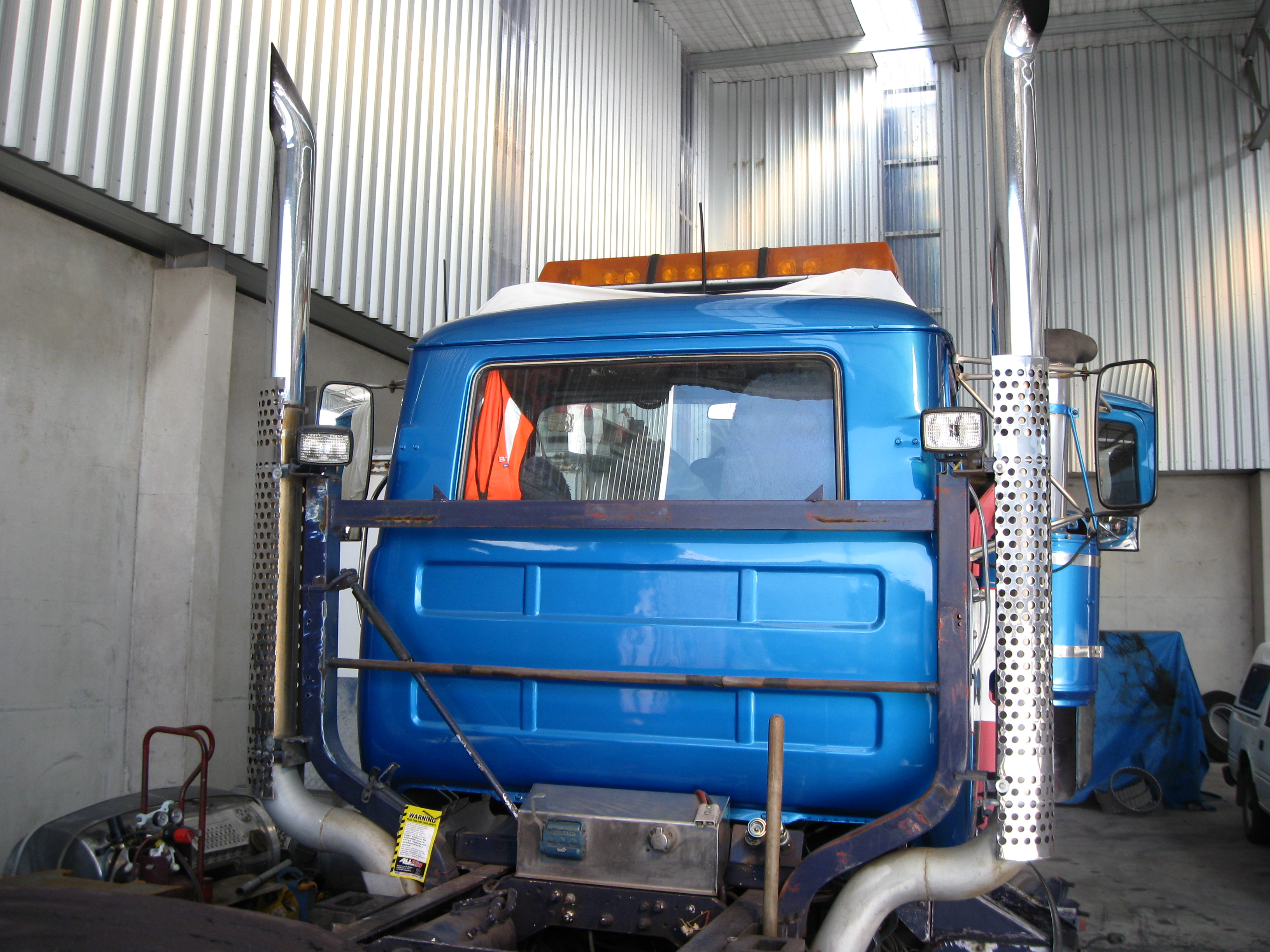

mine is made up of a second RHS mount bolted to the chassis, then my original muffler got dealt to with the band saw and is now 1 ft long , I mount this alongside the gearbox and created a new twin system from standard auto exhaust components and up beside the fuel tnaks, then went stainless steel up the RH posts then added Chrome 4fts with mitred ends, the original heat shield off the single verticle muffler got cut in half length ways and rerolled to suit the new vertical 5 inch pipes,
I then made new attach nents for them and bobs your uncle, No heavy dual mufflers waving around in the air.
Nigel
