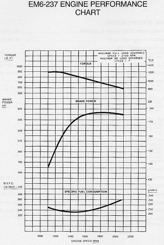

Did Mack at one time use horsepower numbers to ground?
Some people think a 237hp is to the ground that would mean it's 305 at the flywheel
so that means a 350 is 425

I suspect there may be something to that rumor. For examples, the EM6-300 was given 4 valve heads and had it's displacement increased from 11 to 12 litres but the horsepower rating was never increased from 300. On the road, I've found that 237s will keep up with the 14 liter 290/300 Cummins or 8V71 Detroit, and would run away and hide from the L10 Cummings or 6-71. The 285 and 300 Macks would likewise run with a 350 Cummins. I worked for a while for a bulk hauler that ran 425 Cats with the exception of one 350 horse Mack, and the Mack could keep up with the Cats. So clearly Macks will run with other brand engines with 10 to 20 percent more rated horsepower- that's about the driveline losses of a class 8 truck.

the older maxidynes were measured in brake hp. Brake HP is measured at the flywheel and does not compensate for drivetrain losses.
Trent
Thanks, Trent
all of the spec's I could find was at the flywheel.
Maybe the (AC) chain drive was to the ground I don't know.
