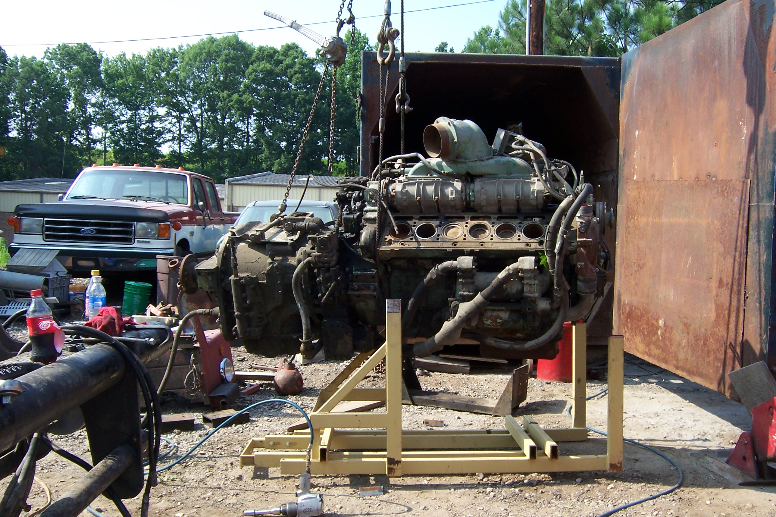

So what kind of trans did you decide to put in the truck when you reassemble it?
The Cummins already has a RT14609 attached. I think that's what we 'll use. This auto turned out to be a 5800 series. They were used in 50 ton off road dumps in the 60's.
Sounds like a good choice.
