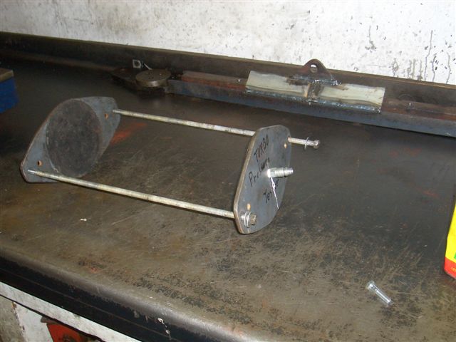

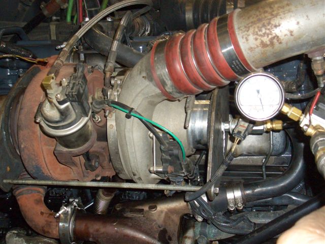

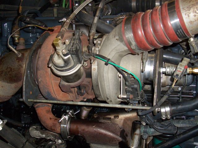

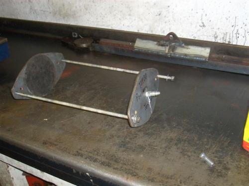

Below is the tool we use to check turbos and boost leaks.

Sorry I put the pics in the wrong post.
Boost /turbo test tool! We use this tool to check for problems like yours it requires you remove the exhast the inlet pipes and the turbo drain tube to check for
the problem you are haveing and apply 30-40 psi air to it!If the turbo passes air thru the turbo drain there inlies your problem if you hear air coming up from the
base still you have other problems ie: rings or valve guides!
Just something else to think on!
Please post your Fixes for others to see!
It makes the fourm more useful and It benefits everyone!
