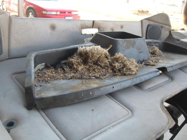

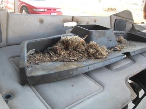

Here it is a beautiful day in the neighborhood and I'm getting ready to get with the program on an older IH cab and fenders. I decide to put my RL797 outside to have room and upon starting the truck to let the air build, and flipping on the clearance lamps, I am treated to a lightning and smoke show that I would have really rather not attended. The first thing I noticed was that acrid smell of burning wiring and I immediately thought to myself: "I got to get stronger deodorant", then "that really smells worse than my feet", then "Holy Shit there Maynard, this SOB's on fire"!!

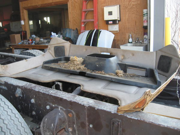

I then shut the lights off, then the engine and since this was not a raging inferno just had to investigate further. Well down comes the headliner, sunvisors, and upper console and to my discovery is all kinds of bare wires for powering the rooftop clearance lamps running under, and through a nice sized mouse nest. This god awful smell that permeated the interior of the cab was nothing less than fresh roasted baby rodents from when I flipped the switch putting power to that wire. I immediately thought, "Halleluya!! The Lord come forth and provideth this fine cuisine for our dining pleasure to fill and nourish our bodies........ Shesh, I didn't even have to wait for the coals to get hot. Life is good.

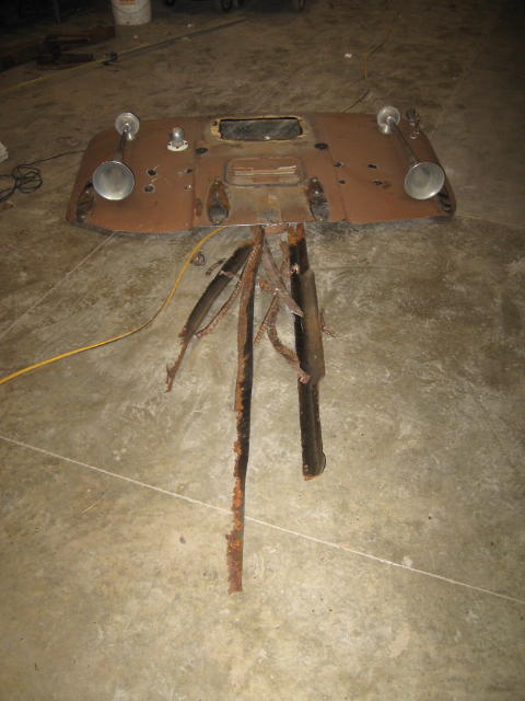

After dinner, (little critters were quite tasty) I went ahead and did a quick survey of the damage which really amounts to very little. All of the wiring has been severly dined upon through the years that this truck sat. I then decided to remove the Kysor roof air unit, and marker lamps. Tomorrow I will remove the air horns and cut the roof skin off of the cab. This is going to take a little rebuilding under the outer skin so don't really know what kind of progress I'll make in the next few days. Got a lot of gutter to make also.

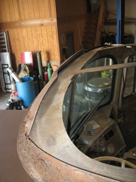

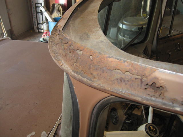

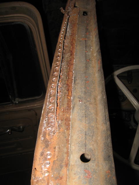

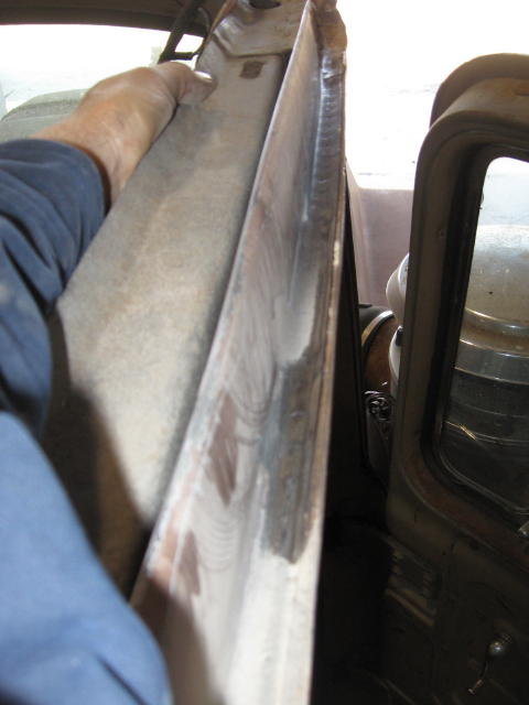

With only a single job in the shop "for hire", I had to find something else to do so I got started on my Mack.
Here's what I mananged to accomplish tonight:

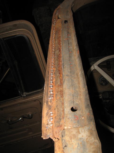

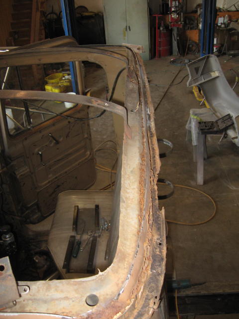

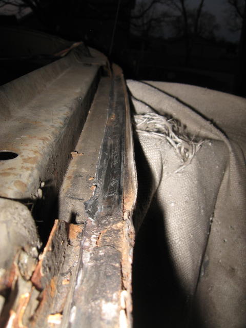

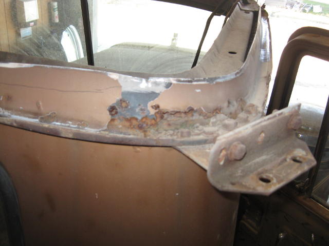

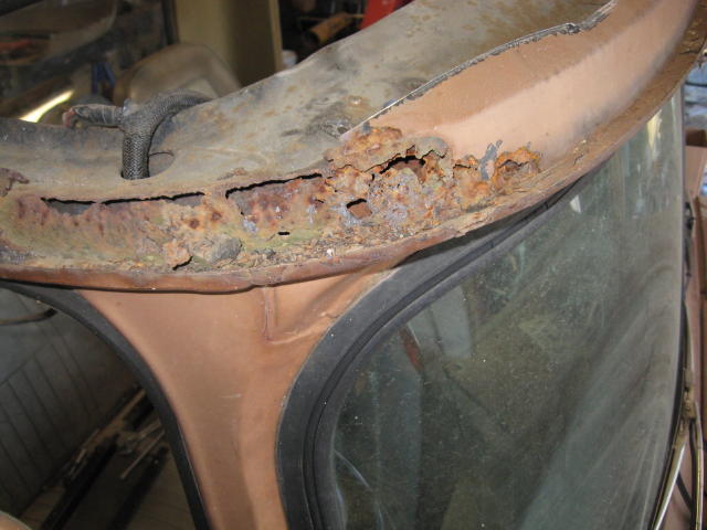

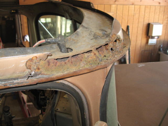

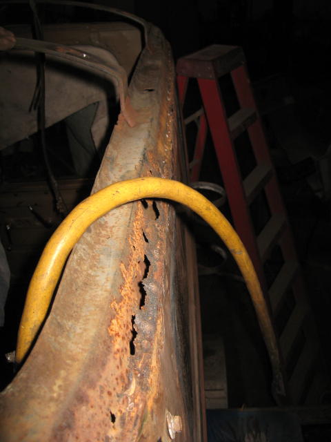

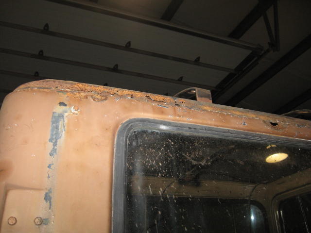

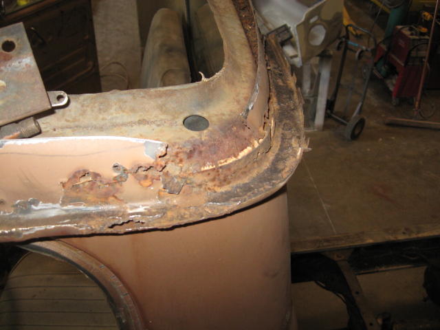

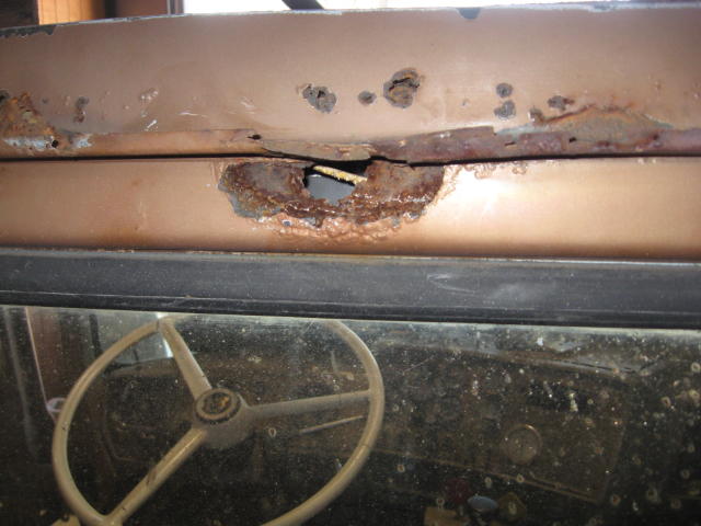

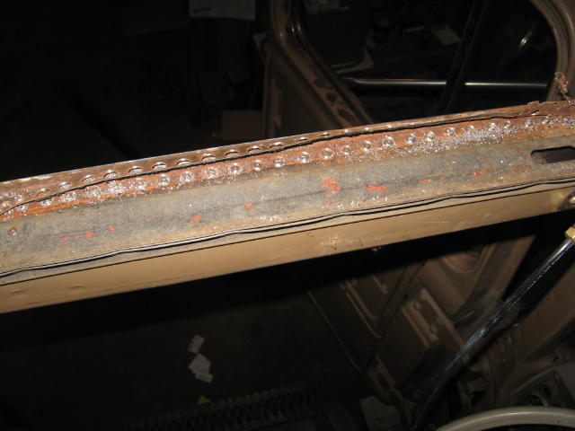

I think you can see by a couple of photos why Mack cabs are so rigid. There are probably 300, (not kidding) spotwelds around the roof perimeter on these cabs. Each has to be drilled out to remove the roof skin. With this cab being a rust repair candidate, I used an air hammer to speed the removal of the skin. The gutter around the cab rear was virtually non existant so I made a little time there by not trying to save anything. The perforation to the inner structure was not readily observable from the beginning but my past involvement told me otherwise. I've got about 4 hours getting to this point wrapped in it. I've probably done this in excess of 20 times through the years but it is still a learning experience for me. I'll make the rain gutter myself and blast out the rust that can be seen. I will then weld new steel patches over the holes after trimming back to solid substrate.

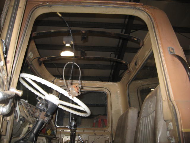

I even made good progress on the IH tonight.

This is the mouse nest that started this mess:
