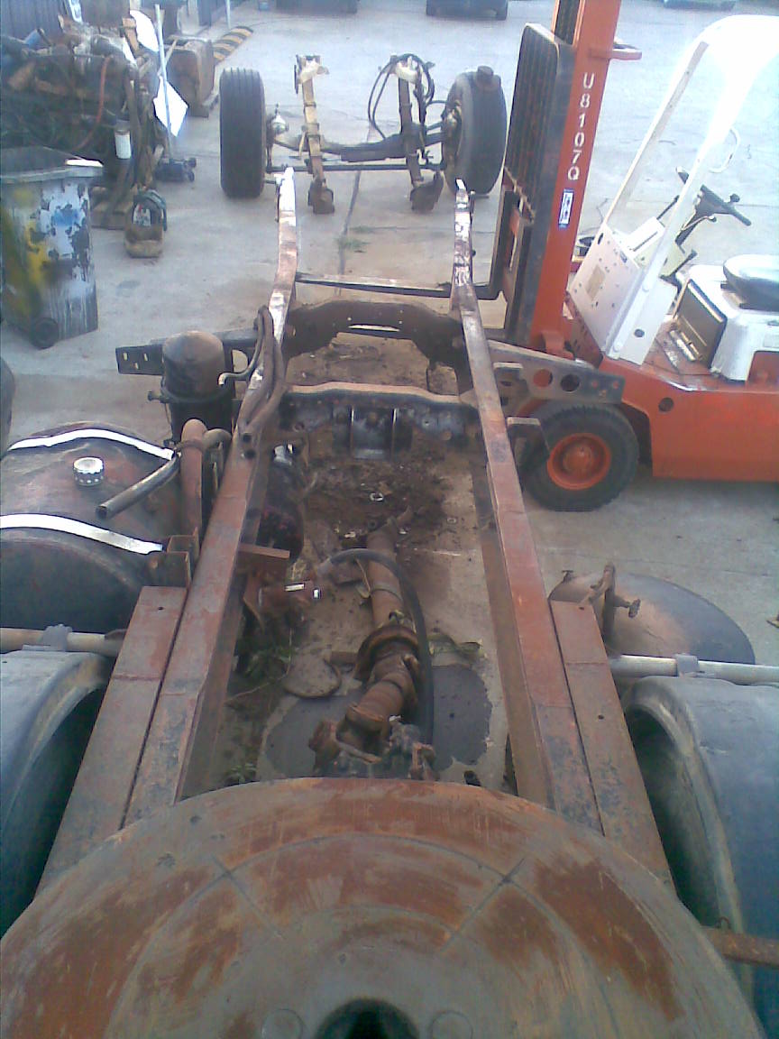

I think the canister on the macks was WGB brand, they were on the early Maxidyne & C motor aswell. They stopped using them around 72 although it may have only been on 6 cyl engines at first. Mack called it ESI, extended service interval. jeffro
i just pulled that off mine, big messy thing! thats it to the left.
