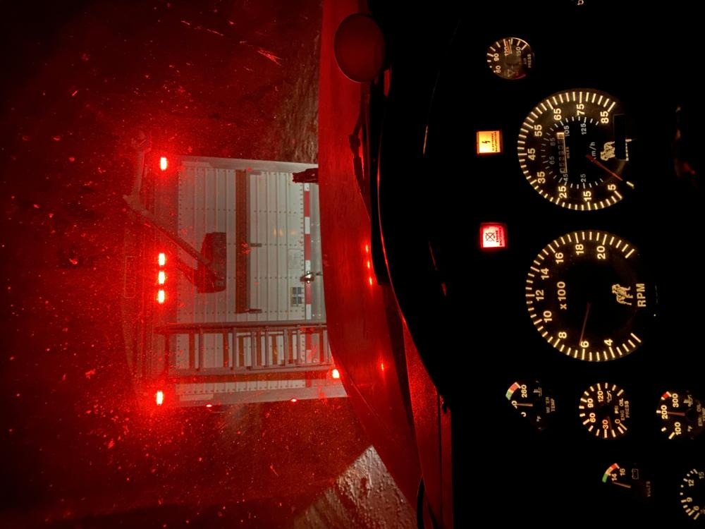

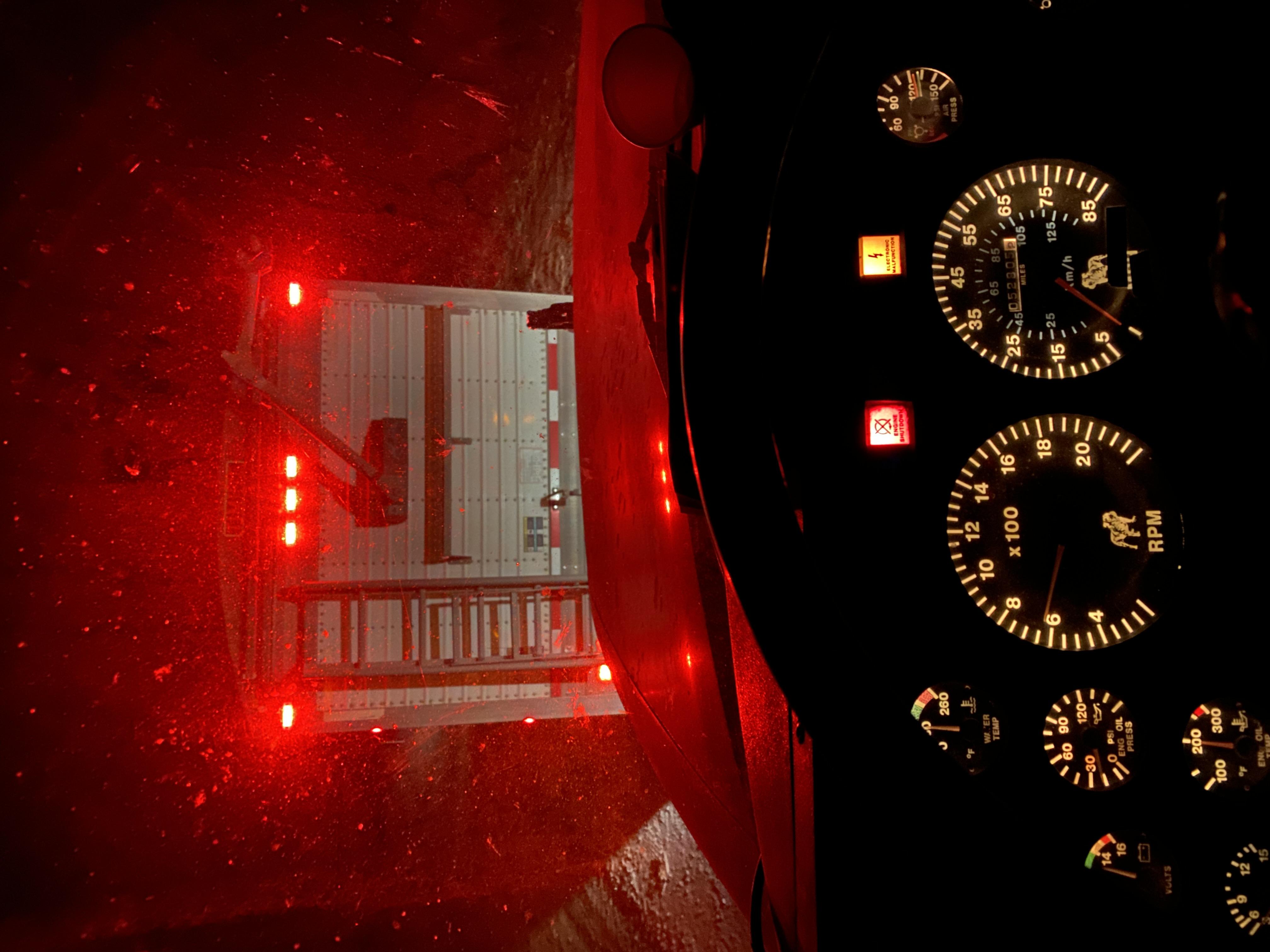

97 mack ch600 or 613 I guess. Shuts down when I stop. Shutdown light comes on and the truck dies but only when I slow to a stop. Runs fine til I come to a stop.  It dies but starts right back and away I go. Help please
My truck does the same thing only while stopping and turns right back on 2000 CX613 E7-460
The mass ground point inside dash on driver side A pillar. Clean and check your grounds.
At least that's what it was on my 2000 CH when I used to have it. Always had the malfunction light coming on and off and the truck randomly shutting off and starting right back up while driving down the highway.
Dealer never could figure it out. They changed all kinds of harnesses and ecm. Was just the mass ground. Found out many years later.
