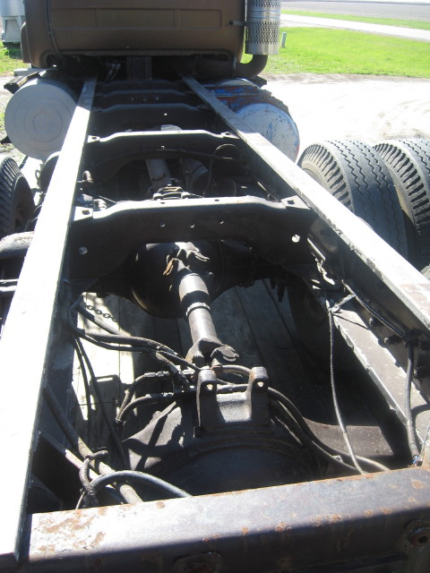

I've got 15' of clear, flat platform behind the cab on my RL797. How long of dump body would go on this for general usage? I've got to stop using Momma's A-40 so need to get another dump truck going for casual usage.
Thanks,
Rob

What's the measurement from back of cab to back edge of rearmost tires?
Hi Herb, there is about 14'6" to the rearmost part of the rearmost tires measured vertically. There is only about six inches of frame "stickout" beyond the rear tires. From this I would need to remove another eight inches to clear the vertical exhaust that I want to keep.
I also want to keep the sides low enough to load with my skid steer loader. I've got 36" sides on the A-40 and that is about the limit.

I'm sure that a 15' bed would fit but a 16' might be better. You need to have enough overhang of the body for the latches and other hardware. Check on the A-40 what the overhang is and that should give you an idea. I would talk to body builders and see what the recommended hang is. You have the hinge, hardware bar, lights, and other crap to consider. Remember that a bed 16' feet in the air creates a lot of leverage that wants to flip the truck, so stay in the seat Rob "The Counterweight" :D
Hi Greg, the hinge at the rear of the A-40 is right at the end and is welded to the frame. The mud flaps are just a couple inches rearward of the tires and are fastend very near the end of the rear of the bed.
I've gravely concerned that if I were to jump out of the seat while the bed is in the air that I may upset the counterbalance action provided by my lard ass. Don't need a truck rotating on it's axis and assuming the "tits up" position unwillingly; Therefore, I don't plan to leave it when operating. I'm having a custom dual air spring seat fabricated to ensure survivability under duress conditions such as supporting my exponential weight gain which is still on an upward spiral.
Although Momma has been chewing on my ass to lose some weight, and get rid of some unused trucks, I'm progressing for a happy medium. The A-40 is hers so it is safe. The Cat powered RL is safe because of it's status. One of the B-61's, (single axle) is alright cause my daughter has laid claim to it, (SHIT, I say), The R795 has attained a slight safety margin cause I need a winch truck. The 58 B-61 is in uncharted territory and may need to be hidden to save. The R-190 IH is safe cause it is my crane and I've had it so long. That is why I MUST get a useful purpose established for this RL. I'm looking at switching to a new job requiring relocation and if something isn't needed, It will have to go. I don't want input from Momma on this one at all cause I know her, and what she'll want.

I'd say go with a 15 ft box.
If you set it back from the cab 8" to clear the exhaust, that would give you 14" overhang past the rear tires.
Cut the hinge angle right into the end of the existing frame and you should be good, that should give enough overhang so the mudflaps don't get sucked into the tires when dumping.

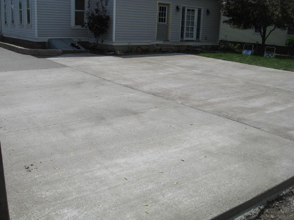

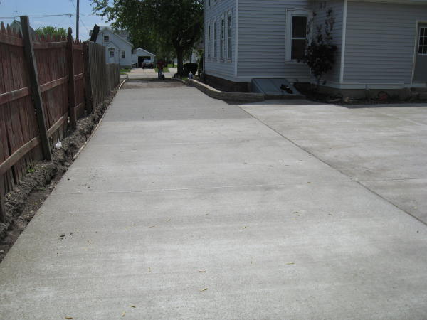

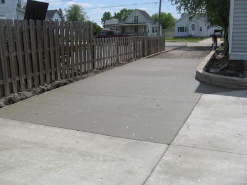

Momma was brought into the loop Saturday coinciding with the new concrete driveway that was finished yesterday at her house. She has temporarily suspended "riding my ass" about getting rid of some trucks due to this, (my assumption).
Hope to re engage this project next week though.
