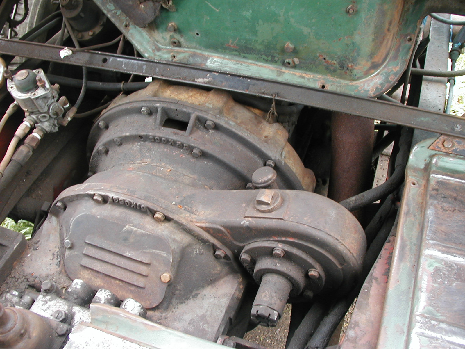

My guess was mixer drive but i don't know. Just another reason this truck is so heavy. i wonder how much of a pain this is to removepost-2286-1245675420_thumb.jpg
fLYWHEEL PTO To remove you will need a new clutch a new input shaft and bell housing!You will odviously have to relocate the engine mounts.

Thanks for your replies. I didn't realize i would need so many new parts . i guess it will stay (for now). Because this is not the original cab someone hacked through a cab crossmember to make clearance for the shifters. I will definitely need to brace the cab floor some other way.

THEY CALLED IT A POWER TOWER HAVENT SEEN ONE FOR YEARS, THEY WHERE GREAT FOR RUNNING A WENCH.
