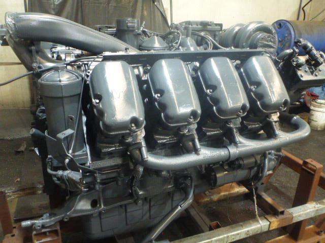

I have been seeing late model cab over V8 Scania's recently in Melbourne Australia and with 1 exhaust pipe, they do sound very similar to the Mack V8's. Yet I have not seen any with 2 stacks.
about 3 months ago I spoke to an owner driver of a cab over Scania with V8 and 18 spd manual box, he pulls a low loader, hauling excavators and similar heavy equipment. He bought it new and said a fantastic truck, motor has never given any issues, good fuel economy and pulls too. And as he got moving fully loaded with 35 ton machine, I was right next to the truck, gee it sounded very close to a Mack E9.
So if all else fails, could the Scania V8 be an option for a good condition Mack Superliner and the Aussie V8 Valueliner, and given it is current Scania motor it would meet the latest emissions regs in USA and Aust! I wonder how compatible the engine mountings are for Mack E9 and the Scania V8?
A comparison is the Subaru boxer 2 litre motor being fitted into VW Beetles and the VW Combi wagons.
I also notice there appears to be many of the V8 Scania's in the UK and Ireland, that travel across Europe, single and tandem drives with tri-axle fridge or dry pantechs.

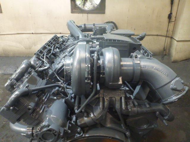

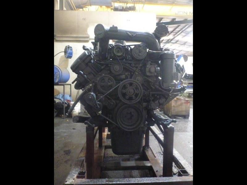

There you go Paul, it sounds very close to a Mack V8! So apart from keeping 100% Mack, if desire is to have a V8 as close as possible to an E9, and want to keep a Mack truck going, it seems to me that say resting and preserving the E9 in the shed, running a Scania V8 for working purposes (reliable and compliant for the regs etc) then it would be a win/win.
https://www.bigmacktrucks.com/topic/9841-mack-e9-v8/page/3/#findComment-483079
I have just looked up Sacnia V8 DC16 engines for sale in Australia. This English motor is 2006, tested and price is $Aust 22,000 ($US 17,000). The English motors have not been worked any where near the E9's as in Australia. It looks similar in size to an E9, so it should fit into the Mack engine bay comfortably and with our hydrogen unit fitted onto it, it would reduce 80% of emissions. Compared to the cost of an E9, considering all else, this would be a practical option to keep a Mack Superliner and Aussie Valueliner operating for many successful years, plus the joy of having your Mack working. And the E9 preserved, so the Mack could be returned to original specs.
